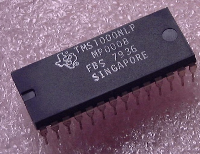

Texas Instruments' TMS 1000
Texas Instruments' TMS1000. Image used courtesy of Christian Bassow via Wikimedia Commons (CC BY-SA 4.0)

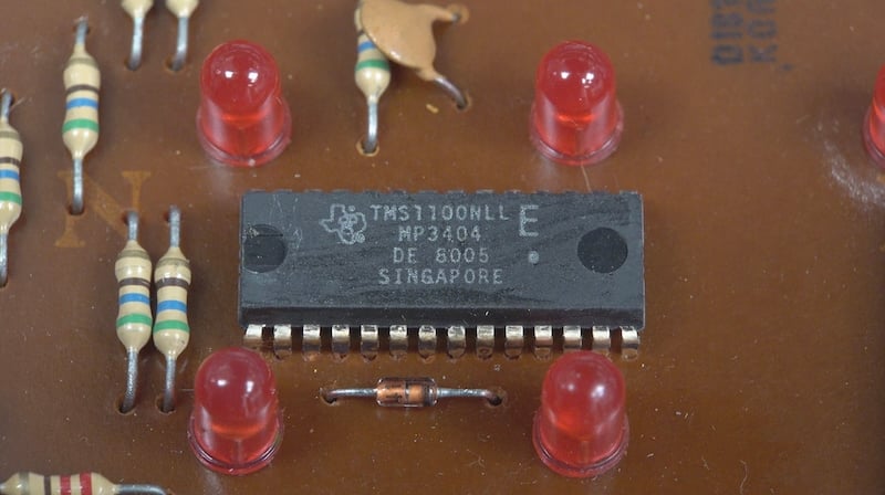

TMS1100 MCU in the Parker Brothers Merlin electronics game
The TMS1100 MCU in the Parker Brothers Merlin electronics game. Image used courtesy of Binarysequence via Wikimedia Commons (CC BY-SA 4.0)
In terms of electrical behavior, its outputs were open drain, with optional pull-down characteristics defined at manufacture. This allowed the device to interface with higher-voltage loads and multiplexed displays without complex drivers. Variants in the family extended these capabilities further, including parts intended to drive high-voltage display elements directly and later members that doubled ROM and RAM capacity.
