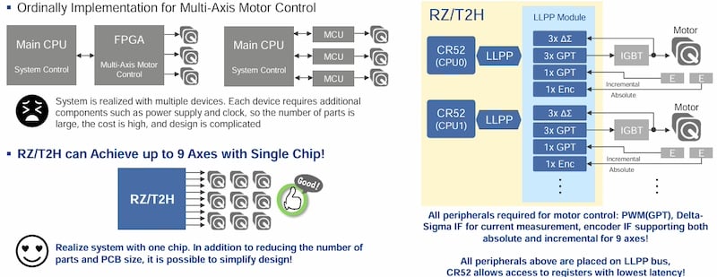

Renesas claims the new RZ/T2H is the industry’s first single-chip, nine-axis control solution. Competitive solutions require multiple microcontrollers or FPGA add-ons to meet nine-axis requirements. The RZ/T2H has all necessary hardware built-in, including pulse width modulation (PWM) drive, Delta Sigma interface for current measurement, and encoder interfaces capable of absolute and incremental positioning. All peripherals are on a low-latency bus with direct register access.
As mentioned, the multi-core processor has one to four Arm Cortex A55 64-bit cores for applications processing at 1.3 GHz. It supports external LPDDR4-3200 SDRAM with a 32-bit bus. A pair of Cortex-R52 cores running at 1 GHz handle real-time processing. The A55 delivers a 20% increase in performance over the A53 used in prior generation chips from Renesas.
Comparing multi-chip, nine-axis solutions
Comparing multi-chip, nine-axis solutions (right) to the new Renesas RZ/T2H single-chip nine-axis solution (left).
The RZ/T2H has all the drivers, encoders, and current measurement electronics for a nine-axis system built in. Conventional multi-axis systems tend to require significant external circuits, often including multiple microcontrollers, to provide the same functionality.
