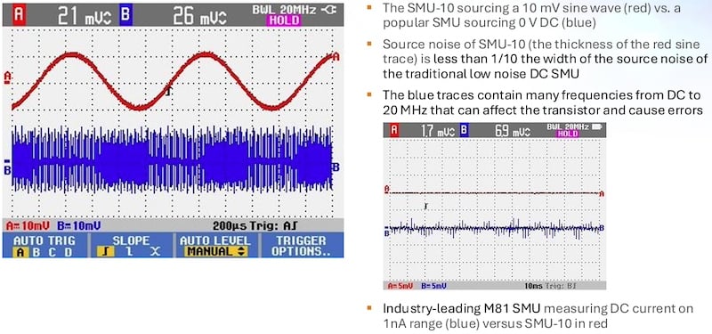

The Lake Shore Cryotronics SMU-10 operates with extremely low noise parameters and high sensitivities of below 10 nV/√Hz (AC) and below 100 fA (DC) with maximum voltage/current levels of ±10 V and ±100 mA DC/peak.
Comparison of noise level from SMU-10 readings vs. competitive SMUs
Noise level from SMU-10 readings vs. competitive SMUs. Image used courtesy of Lake Shore Cryotronics
