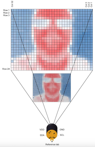

The MLX90642's pixel arrangement in the FOV.

The MLX90642 comes with two FOV options available for purchase. The options are distinguishable by a -BCA or a -BCB product code. The BCA provides a wide FOV at 110°x75°.  The BCB versions have a smaller FOV of 45° x 35°.
Depending on the version, the pixels of the sensors are divided into zones, each with varying levels of accuracy. The BCA sensors have four zones, while the BCB sensors have two zones. These options allow system designers to choose between performance and field of view based on their application requirements.

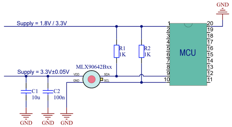

Melexis' recommended application diagram of the MLX90642
Melexis' recommended application diagram of the MLX90642.
The MLX90642’s internal registers can be accessed to monitor the sensor’s progress. It can be set to continuous, step, sync request, or sleep modes. Several configurable parameters can be modified using a configuration command. The MLX90642 is equipped with a programmable refresh rate from 2 Hz to 16 Hz. Designers can choose to opt for more FPS at the cost of worse noise performance. Users can also request a global shutter readout for the full raw image. Emissivity and background temperature can be calibrated to further improve readings based on the application.
