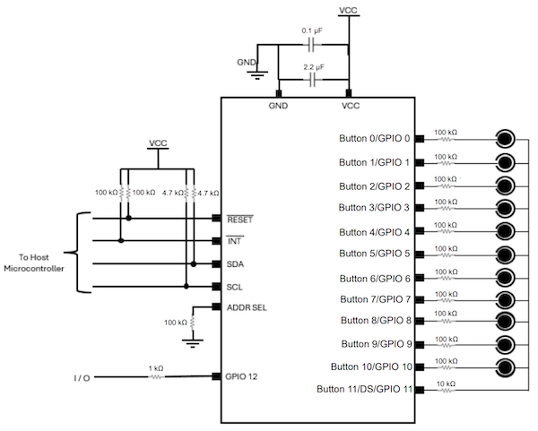

Example circuit using 11 buttons with driven shield
Example circuit using 11 buttons with driven shield.
I2C is a two-wire serial bus that enables communication between multiple devices while minimizing the amount of I/O resources. This allows the MTCH2120 to operate at 100 kHz but can support up to 1 MHz depending on the supporting devices, making it useful for pin-constrained applications. This can enhance simplistic designs and ease the implementation of water-tolerant touch buttons and proximity sensing in various applications. Microchip says the MTCH2120 controller can support up to 12 capacitive touch buttons and can accommodate diverse product requirements ranging from the automotive to industrial appliance industries.
