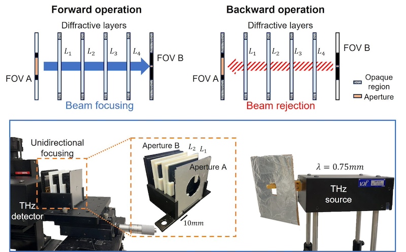

UCLA researchers have developed a compact optical system that focuses light in only one direction using passive diffractive layers. Traditional unidirectional light control methods rely on nonlinear materials or specialized structures that are complex, expensive, and power-hungry. They’re also sensitive to light polarization and wavelength, which limits real-world use. The UCLA team, led by Professor Aydogan Ozcan, took a different approach. They used deep learning to design isotropic, passive diffractive surfaces that don’t depend on exotic materials or active components. These structures can control light asymmetrically without external modulation or high-power lasers.
Unidirectional light focusing enabled by structured diffractive surfaces
Unidirectional light focusing enabled by structured diffractive surfaces. Image used courtesy of UCLA
In their experiments, the team built a two-layer diffractive structure using 3D printing and demonstrated its effectiveness with terahertz radiation. The system allowed light to pass and focus in the forward direction while blocking it in reverse. It worked consistently across a range of wavelengths and didn’t require strict control over the polarization of incoming light. This passive design reduces unwanted reflections and background interference, which is especially useful for systems like biomedical imaging tools, laser machining setups, and precision sensors that can be disrupted by reflected light.

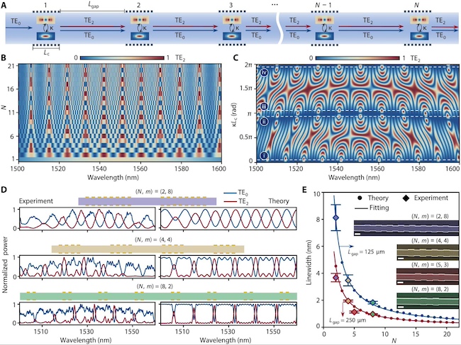

Harvard researchers have developed a new type of interferometer that controls multiple aspects of light—frequency, intensity, and mode—within a single waveguide. This design, called a cascaded-mode interferometer, departs from traditional Mach-Zehnder setups that require splitting light into separate paths. Instead, it uses a nanoscale pattern of gratings etched directly into a silicon-on-insulator waveguide to manage energy exchange between different light modes. This allows the device to shape the light spectrum by controlling how different wavelengths pass through, all without requiring multiple devices in sequence.
A cascaded-mode interferometer
A cascaded-mode interferometer with multiple TMCs for precise tuning of FSR and linewidth. Image used courtesy of Harvard
The result is a compact, integrated platform that performs complex light modulation more efficiently than current technologies. Because it doesn’t rely on physical beam-splitting, it offers better performance in a much smaller footprint. This makes it particularly suited to fiber-optic communications, on-chip quantum computing, and advanced sensing systems where space and precision matter. The team also laid out a theoretical model for extending this approach to manipulate many different light modes, which could further enhance its versatility in optical systems.
