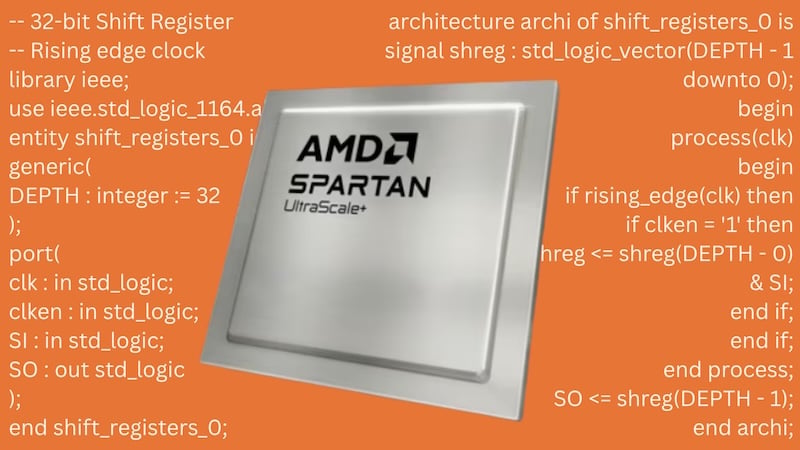

Are HDL languages software or something else? Chip image used courtesy of AMD
Software is the domain of computer science, and at its core, it encompasses any formal description of behavior. HDLs are unequivocally formal descriptions of behavior. They describe, unambiguously, how a system is supposed to operate.

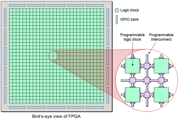

This is where FPGAs come in. FPGAs are mechanisms for implementing state machines, often many state machines working together. Physically, an FPGA die is a fabric of many thousands of tiny state machines called combinatorial logic blocks. Sometimes those collections form a Turing machine, but often they do not. If I pulled up to your house with a truck full of gears and cogs, you could make a computer, but that probably would not be your first thought. An FPGA is just a truck filled with tiny state machines.
An FPGA’s programmable fabric allows designers to rapidly program (and
re-program) the device to perform nearly any function.
An FPGA’s programmable fabric allows designers to rapidly program (and re-program) the device to perform nearly any function. Image used courtesy of Lattice Semiconductor

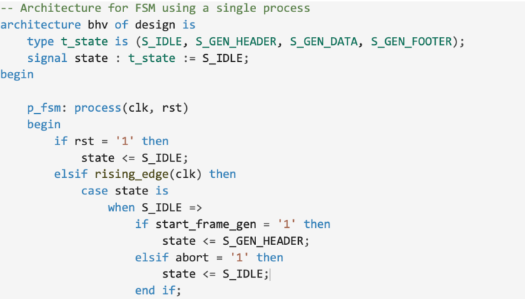

A full critique of VHDL and Verilog is beyond the scope of this article, but one example illustrates the problem. In VHDL, there is a keyword rising_edge(). Under the hood, it instructs the compiler to attach a clock to a flip-flop and latch data on the rising edge of that signal.
But a “rising edge” exists for any changing signal. To use this keyword correctly, the developer must understand that it only works in an extremely specific hardware context. That is unacceptable. Further, it is good practice for all flip-flops to clock on the rising edge, so the language should assume rising-edge clocking. In addition, the programmer should be required to take extra actions to explicitly call out anything outside of that default.
The rising_edge feature in VHDL code only works properly in specific
hardware contexts.
The rising_edge feature in VHDL code only works properly in specific hardware contexts. Image used courtesy of EmLogic

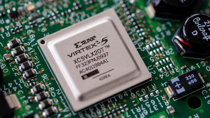

FPGA programming is not hard. It cannot be hard because it cannot express the complexity reserved for general-purpose computing. It is tedious and unpleasant because the languages and tools are decades out of date.
FPGA programming could potentially be simplified with new, improved
languages and tools.
FPGA programming could potentially be simplified with new, improved languages and tools. Image used courtesy of Adobe Stock

    there is so much wrong with this !
    all ff should be on rising edge ! wow.
