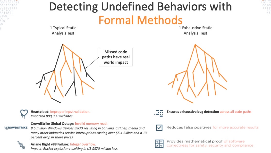

An example of why Formal Verification is important
An example of why Formal Verification is important. Image used courtesy of TrustinSoft. (Click image to enlarge)
Static code analysis inspects source code without executing it. This method identifies bugs, security vulnerabilities, and performance bottlenecks early in the development cycle. Unlike dynamic testing, which runs the code to detect issues during execution, static analysis focuses on the structure and logic of the code. It facilitates compliance with coding standards and detects issues such as leaks, race conditions, and overflows before they manifest in runtime.
The software industry is transitioning toward formal verification and static analysis due to the increasing complexity of modern software systems. Meanwhile, regulatory standards such as ISO 26262 and DO-178C demand higher levels of safety assurance and, therefore, have catalyzed the shift toward these analysis methods. Traditional testing and dynamic analysis often fail to cover all possible edge cases, leaving systems vulnerable to rare but potentially catastrophic bugs. Formal methods guarantee more exhaustive coverage.
