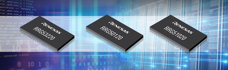

Renesas Introduces Complete DDR5 MRDIMM Chipsets
Renesas recently released “the industry's first” complete chipset solutions for second-generation DDR5 MRDIMMs.
Renesas’ second-generation MRDIMM solutions
Renesas’ second-generation MRDIMM solutions. Image used courtesy of Renesas
Enabling memory speeds up to 12,800 MT/s, the new solutions target AI and high-performance computing workloads requiring substantial memory bandwidth. The solution incorporates three key components: the RRG50120 multiplexed registered clock driver, the RRG51020 multiplexed data buffer, and the RRG53220 power management integrated circuit (PMIC). The clock driver buffers command and address signals between host controllers and DRAMs while consuming 45% less power than its predecessor. The data buffer enhances throughput by multiplexing data paths, and the PMIC provides superior power efficiency and electrical-over-stress protection.
According to Renesas, these products together deliver a 1.35x improvement in memory bandwidth compared to first-generation MRDIMMs. Mass production is anticipated for 2025.
