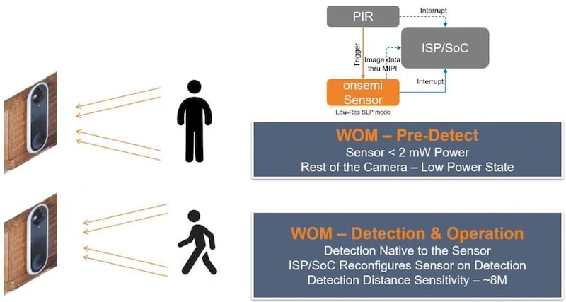

Wake on Motion Within the Image Sensor
All three sensors support in-sensor wake on motion (WOM), which contributes to power savings. The sensors can remain in a standby mode until motion is detected. Many other sensors require the wake on motion logic to reside in the processing side of the device. Doing so requires more power to the sensor even while the main electronics are in low power mode. The new Hyperlux LP sensors have the WOM logic in the sensor allowing it to also be in low power standby along with the rest of the system.
Wake on motion within the sensor for system standby power reduction
By moving the WOM into the sensor, the overall system can be held in low-power mode until motion is detected. The Hyperlux sensors require less than 2 mW standby power and can wake to full power mode in less time than it takes to snap a photo.

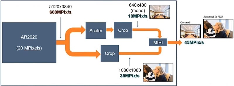

The AR2020, 20 MP sensor also has a feature called Smart Region of Interest (SmartROI). SmartROI allows the system to select a smaller area within the sensor. Many applications, such as video conferencing or traffic cameras don’t require the entire image in high resolution.
For example, a traffic camera may need full resolution coverage in the area that shows an intersection, but not in areas adjacent to the road surface. SmartROI will allow designation of that area as being full resolution while the rest can be viewed at a lower resolution to reduce overall system bandwidth requirements.
Bandwidth reduction with SmartROI
Bandwidth reduction with SmartROI (Smart Region of Interest)
By cropping the high resolution imagery to the region of interest, applications such as video conferencing or traffic cameras can provide the detail necessary for operation at a significantly reduced bandwidth.
While this is a common feature of vision systems, current systems perform the operation downstream with software. With the AR2020, the region selection and discrimination is handled within the sensor, reducing bandwidth at the start and reducing processing load downstream.
