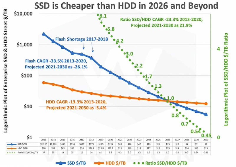

Modern applications strike a different tradeoff compared to general computing applications. While consumers or embedded designers may prefer a better price/GB, data-centric applications place more emphasis on read/write speeds, data volume density, and efficiency—all while maintaining familiar form factors. Phison’s Pascari brand of SSDs aims to strike this balance in enterprise applications to advance the age of AI, bring new performance to data centers, and improve speeds.

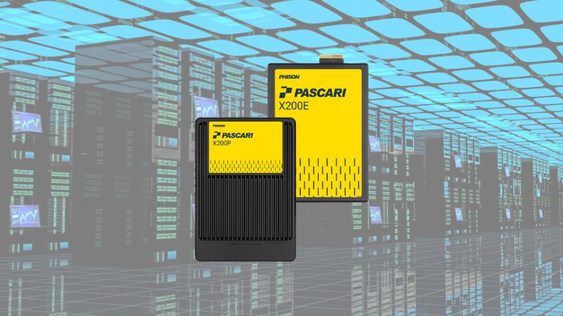

The first entry to the Pascari portfolio is the X200 SSD, a member of the Pascari Performance X-Series. The X200 SSDs are available in U.2 2.5” and E3.S form factors and support single- and dual-port operation. Current capacities are available up to 15.36 TB, with a planned expansion to 30.72 TB and a max power consumption of 25 W across all offerings. This series employs a 3D TLC architecture along with a PCIe 5.0 × 4 interface, yielding latencies down to 10 µs and a max sequential read speed of 14.8 GB/s.

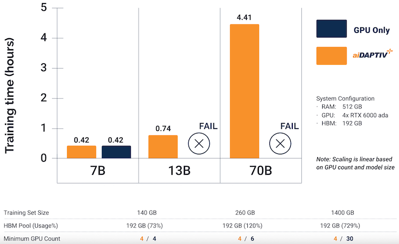

- aiDAPTIV+ | AI-Series to enable custom solutions for AI research and development
Supporting Storage Needs for AI
Although many LLMs or modern AI models can run perfectly fine on consumer-grade hardware, advanced machine learning systems require more processing power and data storage. Phison's new Pascari brand reflects an understanding that data storage and access are equally important to processing in the modern computing landscape.
Phison hopes that its feature set in next-gen AI series SSDs will allow small groups to work with large models.
