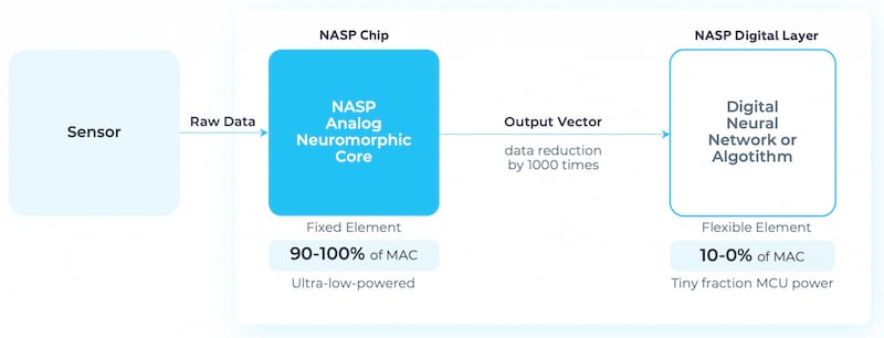

At the core of Polyn’s innovation is NASP, a hybrid analog-digital architecture that mimics the distributed, ultra-parallel operation of biological neurons. Using analog circuits composed of operational amplifiers and programmable resistors, the system performs inference natively on sensor data, eliminating the need for signal digitization or central CPU involvement at the preprocessing stage.
Neuromorphic front-end data processing
Conventional sensor data processing versus neuromorphic front-end data processing.
Polyn built the newly taped-out chip to run a voice activity detection (VAD) model, an edge AI task requiring microsecond latency and microwatt-level power draw. Instead of streaming continuous raw audio to a digital processor or cloud server, the NASP front end filters and compresses the input, outputting only the key embeddings (abstracted feature vectors extracted from signal patterns) that inform higher-level processing.
This front-end intelligence is more than compression: It’s interpretation. By mimicking how the human sensory system relays only meaningful spikes to the brain, NASP enables edge systems to react with speed and efficiency that conventional architectures struggle to match.
A Hybrid Model for TinyML
The NASP platform is split into two conceptual blocks. A “fixed” portion, implemented as hardwired analog circuitry, handles embedding extraction from raw sensor data. This portion is etched during tapeout and serves as a dedicated feature extractor. The “flexible” portion, implemented in standard digital logic or a low-power microcontroller, performs classification or interpretation based on the embeddings.
This hybrid model embodies transfer learning in hardware. Developers can retrain and adapt only the flexible portion of the model, significantly reducing the design cycle and silicon complexity when deploying variations of similar workloads. For instance, an accelerometer signal interpreted for gait recognition could be repurposed for fall detection simply by modifying the downstream classifier.
NASP hybrid concept
The NASP hybrid concept.
A critical enabler of the NASP platform is Polyn’s proprietary compiler toolchain. It converts trained neural networks—often sparse, irregularly connected structures—into dense analog circuit layouts optimized for area, latency, and power. The compiler applies techniques like pruning and connection minimization to translate high-level models into manufacturable chip topologies with up to eight-bit weight precision using resistor-based synapses.
