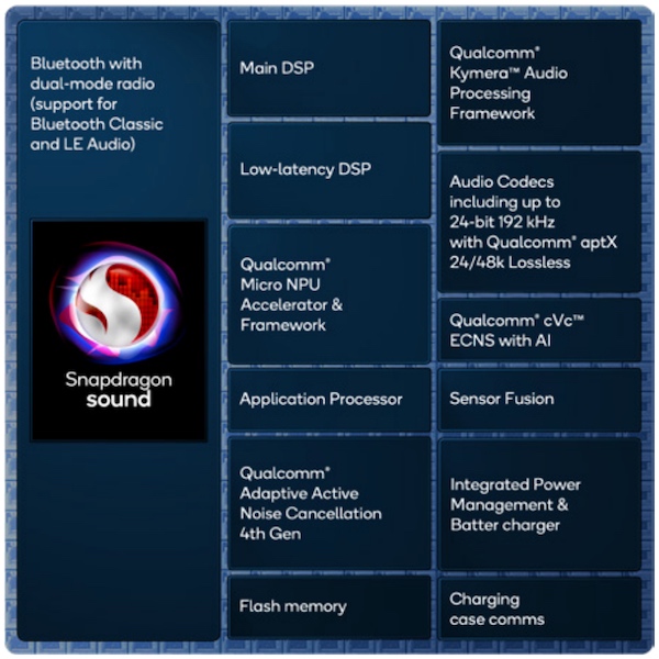

Block diagram of the S5 Gen 3
Compared to the Gen 2's DSP-based AI processing, the S5 Gen 3 uses an NPU for faster AI processing and lower power. The S5 Gen3 adds support for Bluetooth Auracast, a proprietary Bluetooth sharing protocol. Auracast allows compatible devices to share Bluetooth audio with other compatible devices or listen to public Bluetooth Auracast sources.
