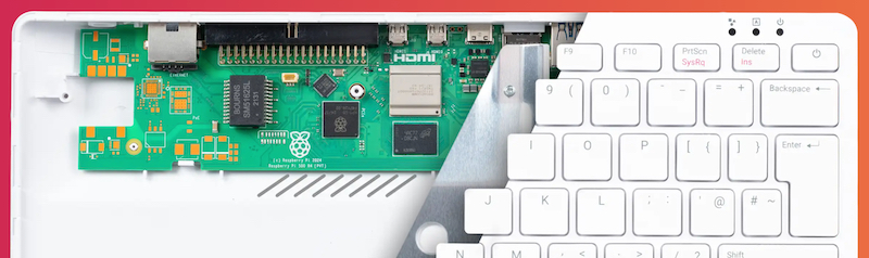

A successor to the Raspberry Pi 400 from 2020, the Raspberry Pi 500 is a complete personal computer built inside of a 70% chiclet-style keyboard reminiscent of an eight-bit home computer like the Sinclair ZX Spectrum from back in the 1980s.
For processing, this device uses the same 64-bit, quad-core Arm Cortex-A76 CPU as the Raspberry Pi 5, along with a built-in aluminum heatsink for improving thermal performance under heavier loads. Additionally, the Pi 500 features 8 GB of LPDDR4X-4267 SDRAM. While the device is void of internal storage, its operating system and data can be loaded onto a memory card via a dedicated microSD slot.
Raspberry Pi 500
Raspberry Pi 500 has the same quad-core 64-bit Arm processor and RP1 I/O controller that appears in Raspberry Pi.
Other peripherals include two USB 3.0 ports, one USB 2.0 port, a gigabit Ethernet port, two 4K micro HDMI ports, and, of course, the classic 40-pin Raspberry Pi GPIO header. As for wireless connectivity, the little computer supports dual-band 802.11b/g/n/ac Wi-Fi communication (at 2.4 GHz and 5 GHz) and data transmission over Bluetooth 5.0 and Bluetooth Low Energy (BLE).
Like most Raspberry Pi SBCs, the Pi 500 supports various Linux-based operating systems, including the latest release of the officially supported Raspberry Pi OS. The Raspberry Pi 500 works on 5-V DC and gets power directly from a dedicated USB-C port. Its price at the time of writing is $90, which includes a 32-GB microSD card pre-programmed with the aforementioned operating system. This specific model will remain in production at least until January 2034.
