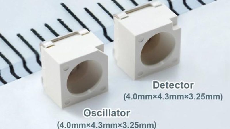

Rohm's THz oscillator comes in a 4 mm × 4.3 mm × 3.25 mm PLCC package with output power ranging from 10–20 µW at 320 GHz. Rohm's detector comes in the same package. With the oscillator and detector facing one another 10 mm apart, Rohm reports a dynamic range of 40 dB.

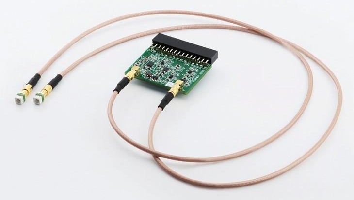

Rohm THz evaluation kit
The Rohm THz evaluation kit allows designers to experiment with RTDs and THz devices and highlights the small size of the oscillator and detector. Image used courtesy of Rohm Semiconductor
The oscillators are not power hungry either, with a typical power consumption of only 10 mW each. This power consumption, combined with the ability to generate/detect THz waves at room temperature, ensures that the devices can be integrated into various applications.

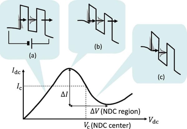

The band profile and I-V curve of an RTD
The band profile and I-V curve of an RTD highlight the negative resistance around VC, allowing high-speed oscillations for THz generation and detection. Image used courtesy of Applied Physics Express
While we won’t dig deep into the governing equations of the quantum well structure within an RTD, we can observe these elements from a system-level approach. The arrangement of ultra-thin layers creates a quantum well with a resonant energy level surrounded by two barriers. As voltage increases, electrons begin tunneling through these barriers, with the current reaching a maximum at a particular bias voltage. If the bias voltage is increased beyond this point, the resistance begins to decrease, creating a negative differential resistance (NDR) that can support oscillation at the THz level due to the high speed of the tunneling effects.

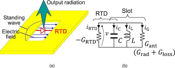

The resonator layout
The resonator layout (a) and equivalent circuit (b) show the method of operation for an RTD oscillator by combining the RTD with an on-chip resonator. Image used courtesy of Applied Physics Express
Oscillations can be radiated into free space by connecting the RTD to a resonator tuned in the THz range. Conversely, if THz radiation hits a detector device with a very similar structure, it can be readily detected, allowing oscillator/detector pairs to send information to sense objects.

Rohm is now sampling its THz devices and offers an evaluation kit with an oscillator, detector, and supporting electronics for designers to get up and running quickly
