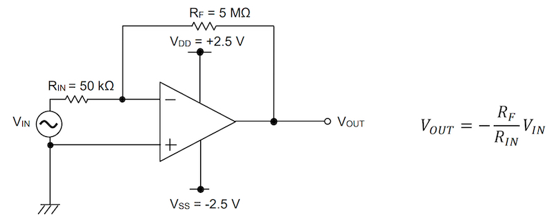

Typical application circuit of the TLR1901GXZ CMOS op amp
Typical application circuit of the TLR1901GXZ CMOS op amp.

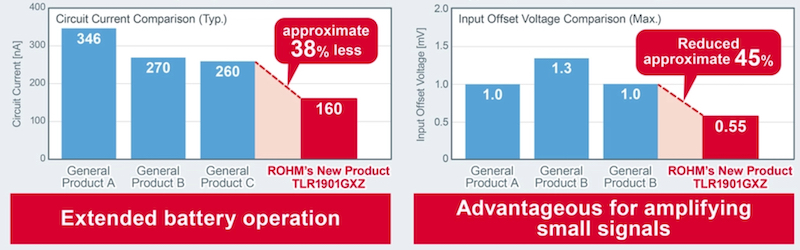

Key to the TLR1901GXZ’s performance is Rohm’s Nano Energy technology. Unlike general low-power op amps that focus on reducing quiescent current at the expense of noise or offset, Nano Energy is a holistic approach that spans device physics, layout, and analog IP. The result is not just lower current draw, but a design that retains full-swing I/O and wide 1.7 V to 5.5 V supply operation with accuracy.
Comparison of low-power op amp characteristics
Comparison of low-power op amp characteristics.
