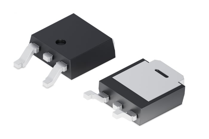

Littelfuse, a leading provider of power electrical components and sensors, announced the release of the 500 V, 2 A IXTY2P50PA (datasheet linked), described as the first “PolarP P-channel power MOSFET” that is AEC-Q101 qualified. The Littelfuse Polar series aims to minimize operating losses by lowering the drain-to-source on-resistance of the MOSFET.
IXTY2P50PA
Littelfuse’s IXTY2P50PA is optimized for high-voltage applications. Image used courtesy of Littelfuse
According to Littelfuse, the IXTY2P50PA has a drain-to-source on-resistance of 4.2 Ω. This results in lower conduction losses at higher currents, because less energy is dissipated as heat. The IXTY2P50PA also has a high avalanche rating, making it suitable for high-voltage applications. The avalanche rating indicates the maximum tolerable reverse voltage that the MOSFET can withstand when it exceeds the maximum allowable breakdown voltage.

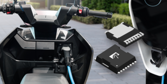

Manufacturers are not only improving MOSFETs in intrinsic gate-level performance but also in packaging. Package size is especially important for two and three-wheeler electric vehicles to reduce overall board size and cut costs. In December, Alpha and Omega Semiconductor announced AOTL66810Q and AOTL66910Q, 80-V and 100-V MOSFETs, respectively.
Alpha and Omega's TOLL package technology
Alpha and Omega's TOLL package technology is specially designed for two- and three-wheelers and other light vehicles. Image (modified) used courtesy of Alpha and Omega Semiconductor
These MOSFETs use automotive-grade TO-leadless (TOLL) packaging that can withstand over 400 A of continuous drain current at room temperature. The company says the packaging shrinks the device's footprint by 30% compared to conventional solutions. Leadless packaging saves space by keeping contact points underneath the device instead of on the perimeter.
Alpha and Omega claims its clip technology helps to achieve a high in-rush current rating and low package resistance and inductance. With these features, Alpha and Omega's clip technology is said to boost EMI performance compared to other TOLL packages that use standard wire-bonding technology. Because of the device's high current and low ohmic features, designers can cut the number of parallel MOSFETs they use in high-current designs.
