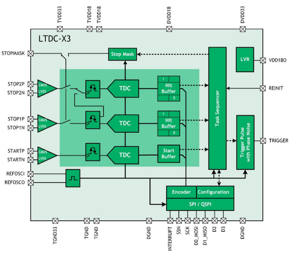

Block diagram of the LTDC-X3
Block diagram of the LTDC-X3. Image used courtesy of ScioSense
For example, its built-in start pulse generator features configurable phase noise so designers can fine-tune the timing signal for external laser diode drivers. The device also includes an on-chip calculation engine for time-of-flight (ToF) and pulse width measurement to reduce the computational load on the host system.
This high level of integration translates to a smaller system footprint and lower power consumption, with the device dissipating only 150 milliwatts under typical operating conditions. For designers of drones and mobile robots, this efficiency eases constraints on battery life and thermal design.
The LTDC-X3’s compact 4 mm x 4 mm QFN32 package further enhances its appeal. By minimizing external components, ScioSense has created a solution that reduces system size and simplifies manufacturing. Meanwhile, integrated noise-masking and trigger-generation modules provide additional flexibility for developers seeking to optimize performance under specific environmental conditions.

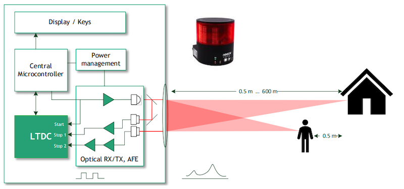

Application diagram of the LTDC-X3
Application diagram of the LTDC-X3. Image used courtesy of ScioSense
Collectively, these specifications are a boon for LiDAR technology, which relies heavily on the precise calculation of light travel times. The LTDC-X3 can register both the rising and falling edges of a pulse across two channels. It also enhances the granularity of time measurements, allowing it to detect multiple objects within a single laser pulse sequence.
