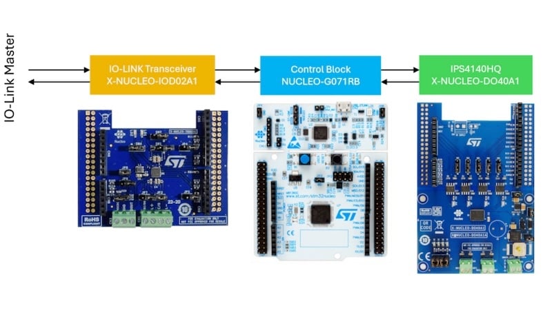

A deeper look at the P-NUCLEO-IOD5A1 shows that it comprises three primary components: the NUCLEO-G071RB board, the X-NUCLEO-IOD02A1 transceiver board, and the X-NUCLEO-DO40A1 digital output expansion. At its core, the NUCLEO-G071RB features an STM32G071RB microcontroller with a 64 MHz Arm Cortex-M0+ CPU, 128 KB of flash, and 36 KB of SRAM.
The MCU also supports advanced memory protection, integrated DMA, and a broad suite of I/Os and system peripherals that unlock robust real-time IO-Link communication.
More information can be found in the P-NUCLEO-IOD5A1 data brief.
P-NUCELO-IOD5A1 block details.
P-NUCELO-IOD5A1 block details. Image used courtesy of STMicroelectronics.
The IO-Link interface itself is realized through the L6364Q dual-channel transceiver on the X-NUCLEO-IOD02A1, which supports both IO-Link and SIO (Standard IO) modes. This device manages the physical layer of IO-Link protocol compliance while maintaining backward compatibility with conventional sensors.
The X-NUCLEO-DO40A1 (in other words, digital output expansion) integrates the IPS4140HQ, which is a quad high-side intelligent power switch that supports loads of up to 0.6 A per channel. Meanwhile, the power switch incorporates diagnostic and protection features that support industrial safety and reliability requirements, with each channel independently controllable and supporting output status feedback to facilitate predictive maintenance and fault localization.
To provide application-level functionality, the kit also includes the FP-IND-IODOUT1 function pack, which integrates a demo IO-Link stack based on X-CUBE-IOD02 and actuator control via X-CUBE-IPS. Developers can use the platform to build and test IO-Link-compliant sensor and actuator nodes while taking advantage of STM32 ecosystem software and tools.
