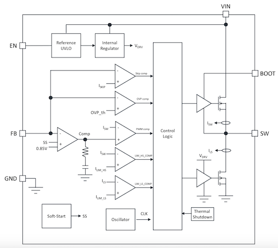

Block diagram of the DCP3601
Block diagram of the DCP3601.

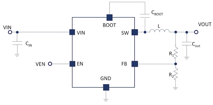

Typical application schematic using the DCP3601
Typical application schematic using the DCP3601.
