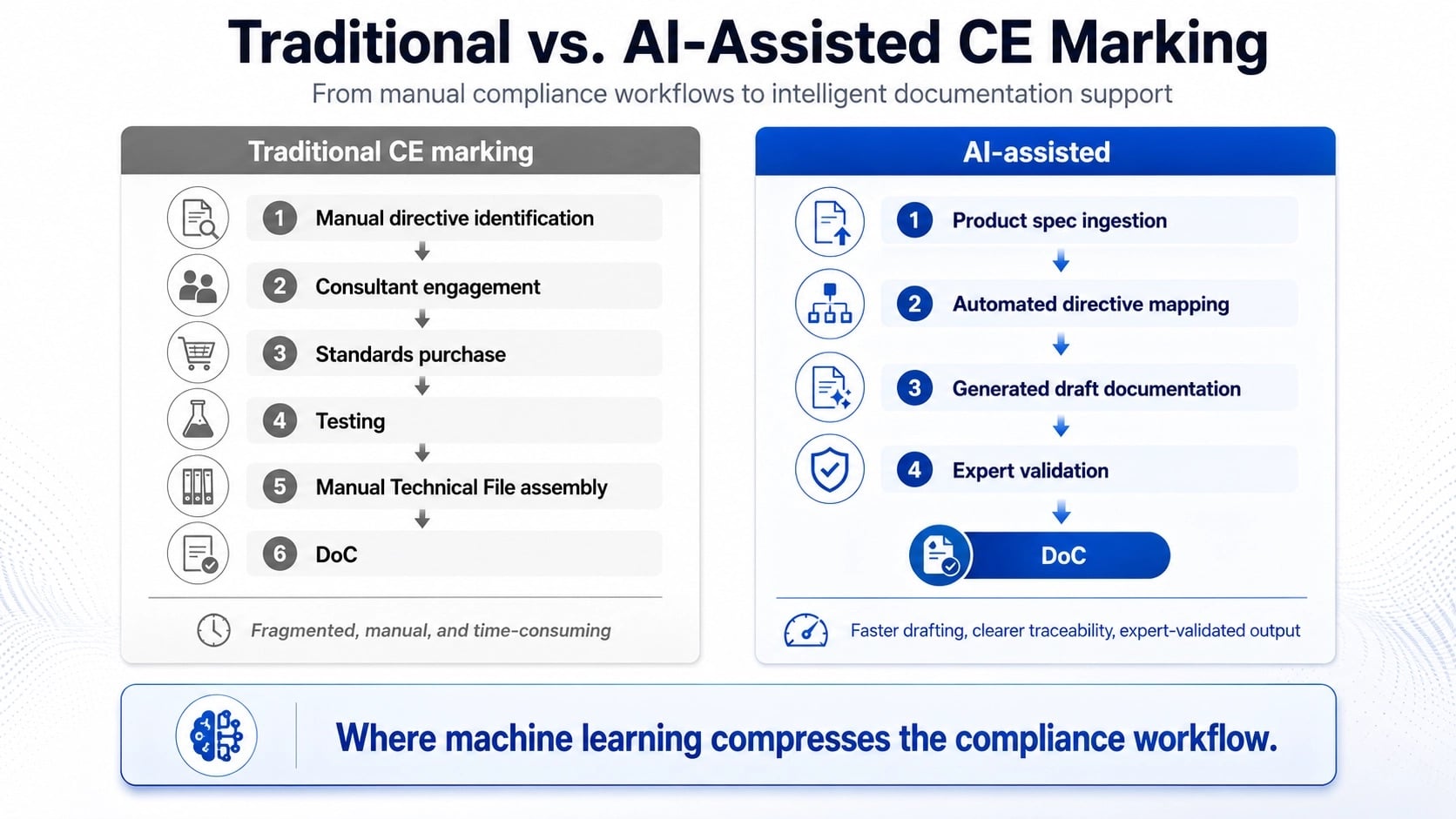

Where machine learning compresses the compliance workflow.
Where machine learning compresses the compliance workflow. (Click on image to enlarge).

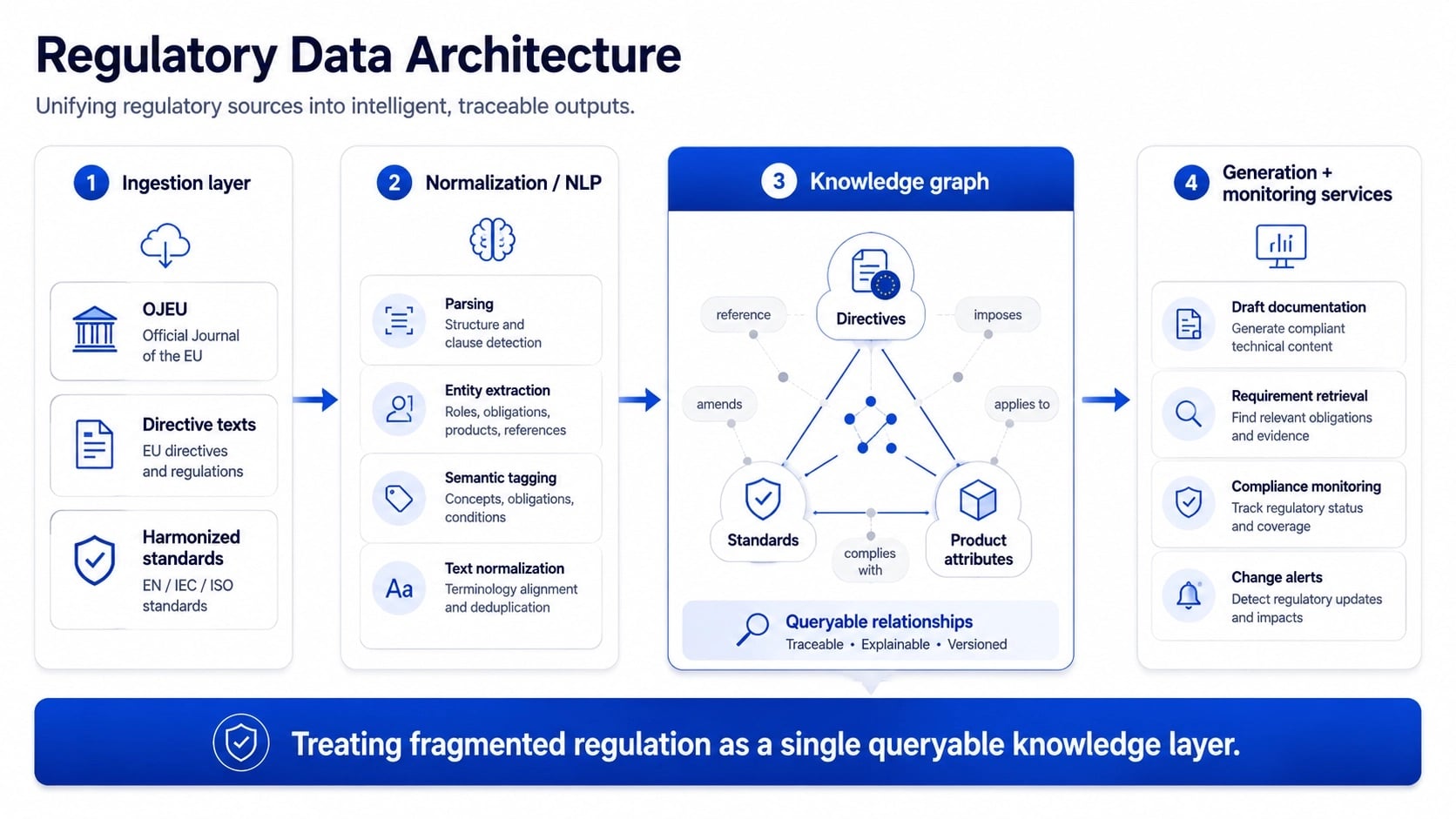

Treating fragmented regulation as a single queryable knowledge layer.
Treating fragmented regulation as a single queryable knowledge layer. (Click on image to enlarge)
1. Regulatory ingestion and parsing.
Directive texts, OJEU standards listings, and member-state guidance are pulled in and processed with natural-language techniques—named-entity recognition to extract directive references, standard numbers, product categories, and obligation clauses; document segmentation to preserve the structure of legal text.
The output is normalized records, not free text, so "EN 55032:2015" in one source and a reference to the same standard elsewhere resolve to a single canonical entity.
2. A knowledge graph linking products to obligations.
The normalized data populates a graph connecting directives, harmonized standards, product categories, and component attributes. When a manufacturer describes a product—function, operating voltage, wireless capability, materials—the system traverses the graph to determine which directives apply and which standards must be demonstrated.
This replaces the consultant's "which rules apply to me?" judgment with a traceable, queryable mapping; however, a qualified technical expert approves the results and makes judgments on edge cases that need further validation.
3. Documentation generation.
With the applicable obligations identified, the system assembles product-specific Technical File contents and drafts the Declaration of Conformity, pulling the correct directive and standard references for that exact product rather than a generic template.
Retrieval-grounded generation—constraining the model to cite the actual regulatory records it retrieved—directly addresses the traceability failure mode that surveillance authorities flag most often, and reduces the risk of fabricated or outdated references that naïve LLM use can introduce in regulated contexts.
4. Change detection and audit trail.
Because the corpus is monitored continuously, the system can diff new OJEU publications against the standards a manufacturer already relies on and flag affected products when a standard is superseded or a directive amended. Every generated document, mapping decision, and regulatory version is logged—producing the audit trail that surveillance and customer audits require, and that manual processes typically reconstruct after the fact.

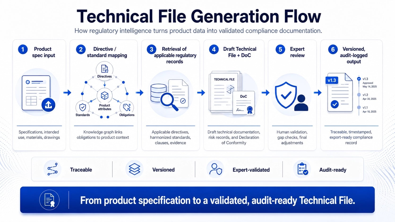

From product specification to a validated, audit-ready Technical File.
From product specification to a validated, audit-ready Technical File. (Click on image to enlarge).
