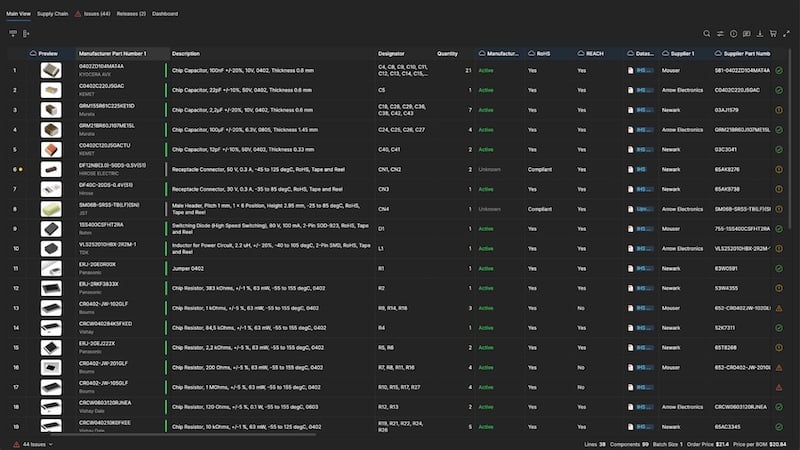

The data goes beyond availability. Lifecycle status, compliance details (RoHS, REACH SVHC), and technical parameters come from a combination of Octopart and IHS Markit. Stock and pricing update daily, and lifecycle data refreshes weekly. When a part becomes unavailable or obsolete, cross-referenced alternatives surface with confidence ratings. This helps engineers maintain design integrity without starting a sourcing search from scratch.
Updates to critical lifecycle information and supply chain data in
Altium. Image used courtesy of Altium.
Updates to critical lifecycle information and supply chain data in Altium. Image used courtesy of Altium

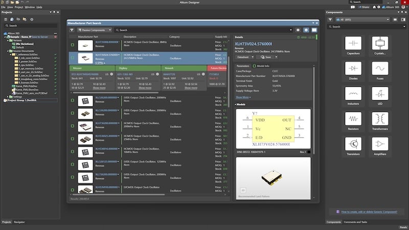

When an engineer hits a roadblock and wonders, “How do I search for a component with in-stock availability across multiple distributors from inside my schematic editor?” They do not have to leave their CAD tool or open a web browser.
Instead, they open the supply chain panel right next to their active schematic. When you type a standard query, the system returns a list of viable parts. The engineer can instantly see who has the part, what it costs, and the current stock levels. This setup helps teams manage BOMs with a live connection to supply chain data. It saves hours normally wasted comparing prices across different distributor websites.
Live pricing, stock, and lifecycle data from multiple distributors are
displayed alongside the component's schematic symbol and footprint. Image used
courtesy of Altium.
Live pricing, stock, and lifecycle data from multiple distributors are displayed alongside the component's schematic symbol and footprint. Image used courtesy of Altium
