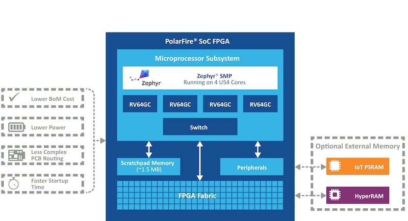

An SMP Zephyr architecture using the PolarFire SoC FPGA.
An alternative system architecture is worth considering: SMP Zephyr at the top of the stack, running on all application cores, executing entirely from on-chip memory and eliminating external DDR from the platform. This model rethinks the hardware–software partitioning and memory architecture from the ground up, favoring tightly coupled compute, predictability and simplified system design over traditional OS-centric approaches.

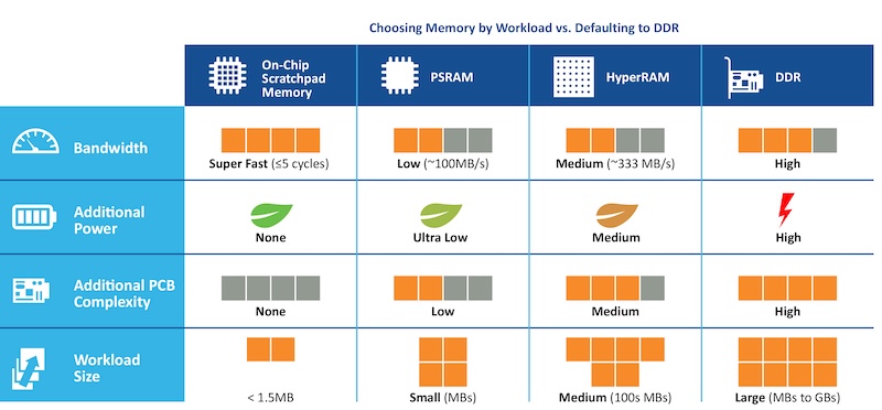

The Memory Spectrum Nobody Talks About
The embedded memory landscape between "on-chip SRAM" and "full DDR" is larger and more capable than it gets credit for. Two options worth serious consideration:
HyperRAM connects over a simple 12-pin HyperBus interface, requires no complex termination or length-matched routing and delivers bandwidth in the range of 333 MB/s—more than sufficient for many embedded workloads that would otherwise reach for DDR. The PCB complexity difference is dramatic. No DDR PHY, no matched pairs, no signal integrity review cycle. A junior engineer can route it.
IoT PSRAM takes this further. Low-pin-count SPI or QPI interfaces, ultra-low power and enough bandwidth for applications that need a working set larger than on-chip memory but are nowhere near saturating DDR. These parts are designed specifically for the class of application where DDR is overkill but on-chip alone is tight.
Memory choices based on workload.
The point is not that these replace DDR for every use case. The point is that the moment you let go of the assumption that it has to be DDR, a whole tier of design choices opens up. Choices that trade raw peak bandwidth for dramatically lower cost, simpler layout, lower power and faster time to a working board.
Most MPU-based systems are locked to a fixed memory hierarchy: your options are narrow and they almost always lead back to DDR. SoC FPGAs change that. PolarFire SoC opens up the design space, letting you rethink how the memory subsystem is built rather than inheriting someone else's assumptions.
Attaching a HyperRAM or PSRAM device is a natural fit. The fabric handles the interface logic; the processor complex sees clean, memory-mapped resources. You get expanded address space without the cost, power and complexity that come with the DDR tax.

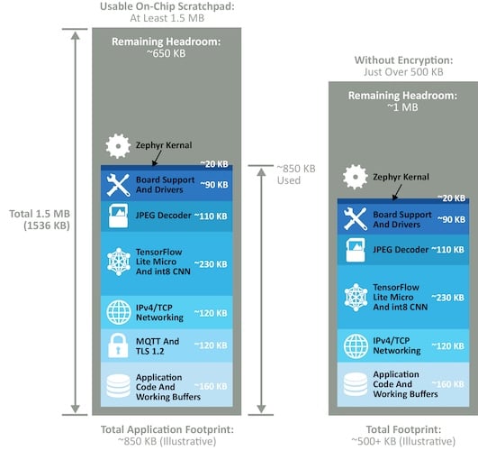

PolarFire SoC includes tightly-coupled on-chip scratchpad memory providing at least 1.5 MB of usable code and data space. Accessed directly by the processor without going through a memory controller, this delivers consistent, low-latency access. Exactly what a deterministic real-time workload needs.
The reason this matters so much for Zephyr specifically is the kernel's footprint. A minimal Zephyr build targeting PolarFire SoC comes in at around 20 KB. That is not a typo. The Zephyr kernel is genuinely lean. It includes only what you configure in, with no hidden OS overhead quietly consuming memory in the background.
From that 20 KB baseline, the image grows with what you add. A realistic application with drivers, a thread pool, a networking stack and meaningful application logic will land well below the scratchpad ceiling. To illustrate what Zephyr can carry while staying entirely on-chip, consider a complete edge AI workload: a single-chip parking lot camera that counts empty parking spaces on the device itself and reports the result back to base, where it can be shown on a website or your maps app and you know if you should park in a lot.
The device will capture a frame every second or so, see how many free spaces are there and report it back. No sending of images back to base or processing required back home. It uses a camera (for simplicity on SPI) to capture images, a JPEG decoder, an int8 convolutional neural network running under TensorFlow Lite Micro, a full IPv4/TCP networking stack over a 10BASE-T1S link, and an encrypted MQTT telemetry uplink secured with TLS 1.2, certificate parsing and all.
Usable on-chip scratchpad, with and without encryption.
The whole thing lands at roughly 850 KB comfortably under 1 MB, a little over half the scratchpad with no external memory of any kind. Strip the encryption layer back out and the same vision-plus-networking node sits just over 500 KB. The instructive part is what that buys you: a feature-complete AI vision pipeline, engineered around small compressed buffers rather than full-resolution rasters, keeps both its code and its data inside a scratchpad—no memory controller, no external DRAM, no flash to attach.
And the chip running it could equally have booted Linux, which would have meant populating external DDR, attaching Flash for a root filesystem and waiting tens of seconds to start, where the Zephyr node needs none of that and is alive in well under a second.
For the majority of embedded applications, industrial control, communications, motor drive, sensor fusion and increasingly on-device AI, the entire application stack stays on-chip. From a 20 KB kernel baseline to a full-featured, secure edge AI node at around 850 KB, with 1.5 MB available. The arithmetic is comfortable.

Zephyr RTOS has matured significantly in recent years, and its SMP support is one of the most important developments for multicore application processors. On PolarFire SoC's quad-core U54 complex, this means:
  • Threads genuinely run in parallel across cores, not time-sliced, but truly simultaneous
  • Core affinity and pinning are supported, giving you deterministic placement of critical workloads
  • The scheduler is real-time throughout, no Linux-style background housekeeping competing with your application
