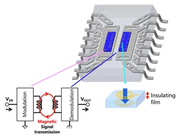

Construction of digital isolator’s isolation
Construction of a digital isolator.
