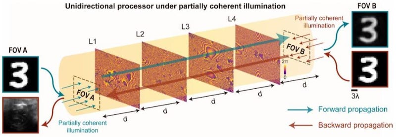

The unidirectional material consisted of multiple carefully designed diffraction gratings that, in combinations, passed partially coherent light images through in one direction while blocking all light in the other direction.
Unidirectional material experiment configuration
An experimental configuration of the unidirectional material. Image used courtesy of UCLA
The test imager consisted of a stack of four diffraction layers, each 200 x 200 pixels, and spaced an even distance (d) from each other. The two image sources, designated as field-of-view A (FOV A) and field-of-view B (FOV B), were also spaced an even distance (d) in front of and behind the diffraction stack.

The partially coherent light source used in this experiment had a phase correlation variation greater than 1.5 times the wavelength (λ) of the light. The source images were 75 wavelengths wide. Polarized light did not affect the unidirectional properties of the material.
Deep Learning in Optical System Design
The team relied on a diffraction grating—an optically clear material made of multiple small lenses or prisms—for this experiment. This material can scatter light in a specific way or randomly to diffuse the light. The layers in UCLA's system scatter the light randomly in one direction but in a controlled manner in the other direction. Four layers are enough to completely block the light in one direction. However, each scattering in the other direction must be compensated for by the next layer in the light-passing direction.
The team struggled to find the right combination of four diffraction layers to completely diffract images in one direction and not the other. To help them hit the sweet spot of material properties to enable such dual capabilities, the researchers leveraged AI deep learning systems to calculate massive levels of permutations. With these algorithms, they found a set of four diffraction gradient screens that performed in the desired unidirectional manner.
