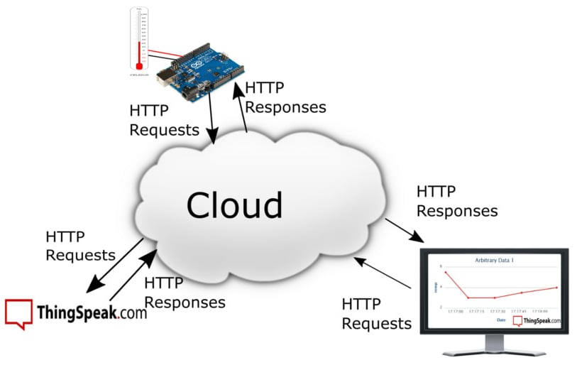

Figure 3 shows a use case for HTTP in the Internet of Things.
Figure 3. ThingSpeak sensor system using HTTP to move data through the internet Image courtesy of ThingSpeak
In figure 3, the Arduino represents a sensor (or sensor system) that collects data and sends it to a cloud based, IoT database. In this example the IoT database is ThingSpeak, but there are a number of other services such as Exosite, Xively, Carriots, and Nimbits that also use HTTP(S) as their interface. The data can then be viewed from any computer on the Internet.

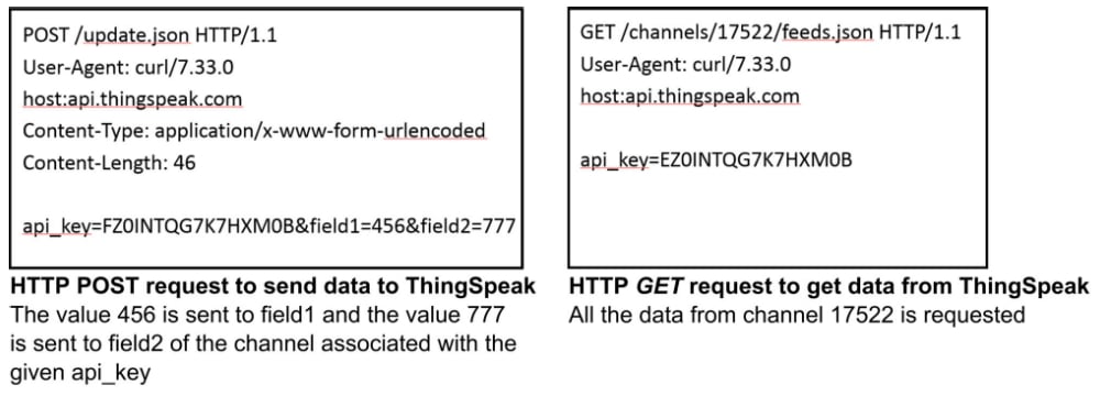

HTTP comes into the picture because the data is being moved around in this system via HTTP requests. The service highlighted in this figure (ThingSpeak) requires users to send an HTTP post request to their channel to send it data and an HTTP get request to obtain data from the channel. The specific requests look like this:
Figure 4. Examples of POST and GET requests to ThingSpeak. Used courtesy of ThingSpeak.
The ThingSpeak interactions shown above are easily implemented as machine-to-machine messages because it is easy to program an embedded device to send HTTP requests and manage the simple responses that it gets back. One thing to note in these messages is the api_key. This key is essentially the password to read and/or write to the channel and if HTTP requests are used to send the key, that means that anyone eavesdropping on your messages would get that key.
The obvious solution is to use HTTPS which adds a layer of authentication and encryption to HTTP. Aside from the authentication and encryption, HTTP and HTTPS messages are the same, so unless there is a compelling reason not to use it, HTTPS should be the protocol of choice for communication with an IoT platform. In some instances, the compelling reason is that the embedded microcontroller sending data to ThingSpeak does not have the processing horsepower to effectively handle the authentication and encryption necessary to use HTTPS. A workaround would be to add a proxy or gateway in between the sensor system and the cloud. For example in a wireless sensor network where each sensor uses a very basic microprocessor, a proxy could collect the data from the sensors over a local wireless network (e.g., Zigbee), and then encrypt the data before sending it out over an HTTPS connection.
