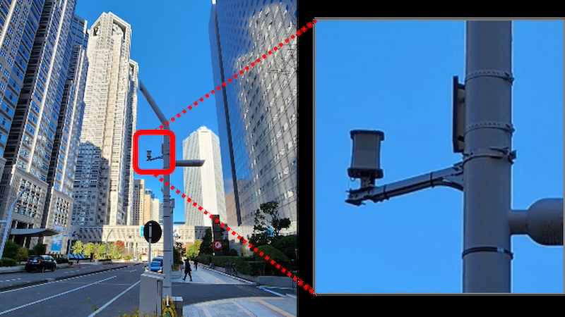

Repeaters installed in Nishi-Shinjuku area
Repeaters installed in Nishi-Shinjuku area. Image used courtesy of Kyocera

Each unit measures 216 mm x 216 mm x 246 mm and weighs 4.9 kg, which the companies claim reduces installation complexity by 70% compared to traditional base stations. The compact design also allows deployment on existing urban infrastructure, such as streetlights, without requiring extensive backhaul connections.

Initial field testing in Tokyo's Nishi-Shinjuku district demonstrated a threefold increase in coverage by expanding street-level connectivity from 33% to 99% within a 600-square-meter area. This testing involved 22 repeaters installed on Tokyo Metropolitan Government and Shinjuku Ward assets as part of the "Connected Tokyo" initiative. The relay technology successfully maintained high-frequency connectivity, even in areas where base stations previously struggled to provide stable service. The repeaters mitigated coverage gaps by detecting and rerouting signals around obstructions, such as buildings and large vehicles.

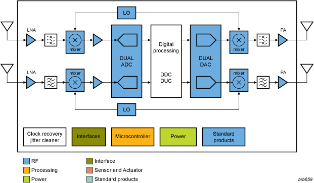

The Circuitry of a Wireless Repeater
A wireless repeater functions as an intermediary device that receives, amplifies, and retransmits signals to extend wireless coverage. Generally, its circuit architecture consists of several components: a low-noise amplifier (LNA), a mixer, a local oscillator, a power amplifier (PA), and a duplexer or circulator to manage signal routing. Together, these components enable the repeater to capture weak signals, amplify them with minimal noise, and retransmit them at higher power to extend coverage without degrading signal integrity.
Internal block diagram of an NXP wireless repeater
Internal block diagram of an NXP wireless repeater. Image used courtesy of Electronic Products
First, the repeater’s antenna captures the incoming millimeter-wave signal, which is typically weak due to high propagation losses. The LNA is the first active stage in the signal path, amplifying the received signal while minimizing additional noise. Once amplified, the signal is downconverted using a mixer and local oscillator (LO). This conversion shifts the high-frequency, mm-wave signal to an intermediate frequency (IF) and allows the repeater’s internal circuitry to process it more efficiently. Some advanced repeaters use direct digital conversion to bypass the IF stage and reduce power consumption and latency.
The downconverted signal is then re-amplified using a power amplifier (PA) before retransmission. The PA is optimized for high linearity and efficiency so that the output signal maintains its original characteristics while operating within regulatory power limits. Modern repeaters often incorporate digital signal processors (DSPs) and beamforming algorithms to dynamically adjust transmission angles and optimize relay paths.
Finally, the repeater upconverts the signal back to its original frequency and transmits it via a high-gain antenna.
