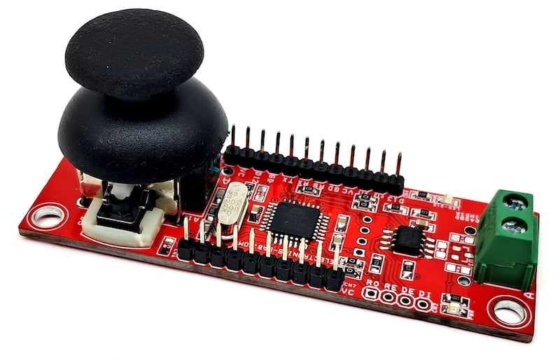

This board is built around an ATmega328 microcontroller and an SN65HVD08DR half-duplex RS-485 transceiver. A 2-axis, 10 kΩ thumb joystick with an integrated tactile switch is mounted directly on the board, along with header connectors for general-purpose I/O and a footprint for an optional 0.96-inch OLED display. Screw terminals bring out the RS-485 A and B lines for the twisted-pair bus cable, and the remaining I/O signals are available on pin headers for expansion (Figure 1).
The ATmega328 samples the joystick's two analog axes and its pushbutton, then formats the readings for transmission over the RS-485 bus. Typical applications include crane control, camera pan-tilt head positioning, and joystick-based motion control for equipment that needs to be operated over a long, noise-resistant serial link.
Figure 1. The assembled RS-485 joystick interface board.

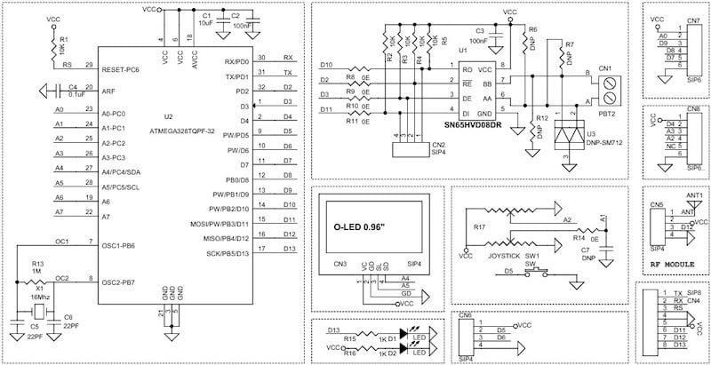

The ATmega328 reads the joystick's two potentiometers on its analog inputs and the pushbutton on a digital I/O pin, then drives the SN65HVD08DR transceiver to send the position data out over RS-485. The transceiver connects to the microcontroller as follows:
  • RO (Receiver Output) = Arduino D10
  • RE (Receiver Enable) = Arduino D2
  • DE (Driver Enable) = Arduino D3
  • DI (Driver Input) = Arduino D11
The SN65HVD08DR combines a three-state differential line driver and receiver in a single SOIC-8 package, compliant with the ANSI TIA/EIA-485-A and ISO-8482E standards. It operates from a 3 V to 5.5 V supply, draws less than 90 mW of quiescent power, and includes open-circuit, short-circuit, and idle-bus failsafe biasing on the receiver. Its driver output slew rate is limited for clean signal quality at data rates up to 10 Mbps, and its bus pins tolerate ESD events above 16 kV (HBM), making it a rugged choice for an RS-485 node that may see long cable runs or a noisy electrical environment.

Figure 2. Schematic for the RS-485 Joystick Interface Board.

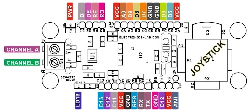

Figure 3. Connector and pinout map for the joystick interface board.
CN1 — RS-485 Bus (2-pin screw terminal):
  • Pin 1 = RS-485 Channel B
  • Pin 2 = RS-485 Channel A
CN2 — Optional, not used
CN3 — 0.96-inch OLED Display Header (optional)
CN4 — Bootloader/Programming Port (8-pin):
  • Pin 1 = TX
  • Pin 2 = RX
  • Pin 3 = Reset
  • Pin 4 = GND
  • Pin 5 = VCC
  • Pin 6 = D11
  • Pin 7 = D12
  • Pin 8 = D13
CN5 — 433 MHz RF Module Header (optional)
CN6 — I/O Header (4-pin):
  • Pin 1 = VCC
  • Pin 2 = D5
  • Pin 3 = D6
  • Pin 4 = GND
CN7 — I/O Header (6-pin):
  • Pin 1 = VCC
  • Pin 2 = A0
  • Pin 3 = D9
  • Pin 4 = D8
  • Pin 5 = D7
  • Pin 6 = GND
CN8 — I/O Pad, Underside of PCB (6-pin):
  • Pin 1 = VCC
  • Pin 2 = D4
  • Pin 3 = A3
  • Pin 4 = A2
  • Pin 5 = NC
  • Pin 6 = GND
JOY1 / R17 — 2-Axis Thumb Joystick, 10 kΩ:
  • X-axis output to Arduino A1
  • Y-axis output to Arduino A2
  • Integrated pushbutton switch to D5
D1 — Function LED, tied to D13
D2 — Power LED

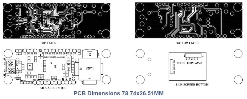

Figure 4 shows the PCB layout, top and bottom copper layers, and board dimensions.
Figure 4. PCB layout for the joystick interface board, 78.74 x 26.51mm.
Figure 4. PCB layout for the joystick interface board, 78.74 x 26.51 mm.
