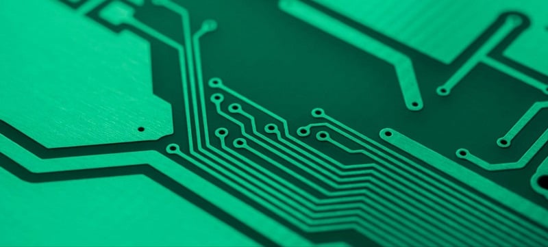

Digital signals, especially high-frequency digital signals, will gladly use your PCB traces (Figure 2), component leads, and interconnects as antennas. The wide range of sinusoidal frequencies present in rapid logic-level transitions ensure that there are plenty of opportunities for higher-efficiency conversion between the electrical and electromagnetic domains.
Close-up view of a PCB.
Figure 2. PCB traces can function as antennas. Image used courtesy of Adobe Stock
However, digital signaling is inherently robust against received EMR. This is because interference will impair performance only if it’s strong enough to push a voltage to the other side of the logic threshold.
