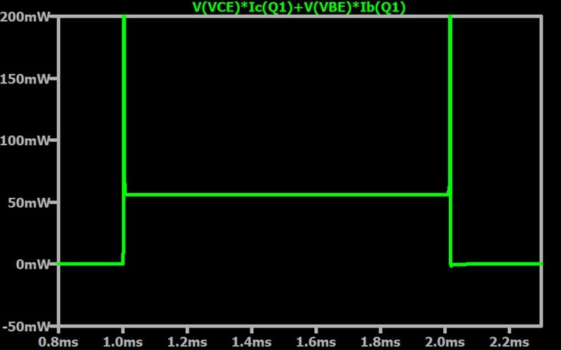

SPICE simulations provide another, more accurate way of estimating conduction loss. Consider the LTspice circuit in Figure 2, for example. Q1 of this simulated bipolar junction transistor is controlled by a 3.3 V digital signal and switches current to a 50 Ω load.
An LTspice bipolar junction transistor circuit.
Figure 2. A bipolar junction transistor modeled in LTspice.
Figure 3 shows the base-to-emitter and collector-to-emitter voltages that result when we run the simulation.
A simulated BJT switch's base-to-emitter and collector-to-emitter voltages during the active portion of the switching cycle.
Figure 3. Base-to-emitter voltage and collector-to-emitter voltage during the active portion of the switching cycle.
The LTspice plot shows a VCE of 208.5 mV, which is very close to the 200 mV value we assumed in the preceding section. By contrast, VBE is significantly higher than we assumed—934 mV instead of the expected 700 mV.
We could insert these new values into our circuit-analysis calculations and generate a new estimate for conduction loss, but it’s much easier to let LTspice do the math for us. Just hold down the Alt key—or the Command key, if you’re using a Mac—and click on the transistor; LTspice will generate a plot like the one in Figure 4.
Transistor power consumption calculated and plotted by LTspice.
Figure 4. Transistor power consumption calculated and plotted by LTspice.
The results indicate that this BJT switch will dissipate a consistent 56 mW of power during the active phase of the switching cycle.

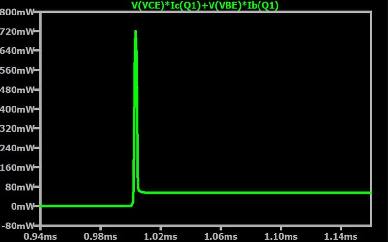

Those ominous spikes in the power-consumption plot above suggest that conduction loss isn’t the only type of power dissipation that we need to discuss. Figure 5 shows what happens if we zoom in on one of those spikes.
BJT power dissipation during the transition from switch-off to switch-on.
Figure 5. BJT power dissipation during the transition from the non-conducting cutoff state to the saturated conducting state.
These spikes occur because a BJT can’t change instantaneously from a non-conducting state to a fully conducting state. During the transition, significant collector current is flowing, and the collector-to-emitter voltage hasn’t yet settled into its low saturation level. Power dissipation is therefore relatively high.

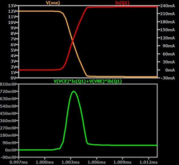

You can see these current–voltage dynamics in Figure 6. The orange and red curves plot collector voltage and collector current, respectively; the green curve plots power dissipation.
Collector voltage, collector current, and total BJT power dissipation during the transition from switch-on to switch-off.
Figure 6. Collector voltage, collector current, and total BJT power dissipation during the transition from the switch-off state to the switch-on state.

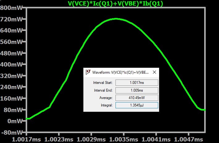

Let’s look at an example. Starting with the plot above, I can hold down the Ctrl key and click on the waveform label to perform integration (Figure 7). The area under the power curve represents energy loss, and this energy can be added up and divided by time to produce the average power dissipation due to BJT transition.
Integrating an instantaneous-power waveform with LTspice.
Figure 7. Integrating an instantaneous-power waveform with LTspice.
This indicates that each transition causes about 1.35 μJ of energy loss. Let’s say we’re switching at 500 Hz, or five hundred cycles per second, which corresponds to one thousand transitions per second. The total energy loss per second will be 1.35 μJ × 1000 = 1.35 mJ. The average power dissipation due to transitions is therefore 1.35 mW.

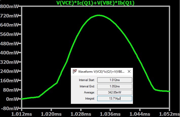

Both of these factors strongly influence transition losses. For example, Figure 8 demonstrates that increasing the control signal’s rise time from 10 μs (the value used for the above simulation) to 100 μs raises the energy loss from 1.35 μJ to 13.7 μJ.
