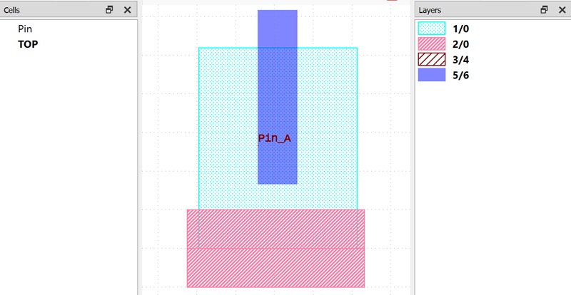

Consider the simple layout in Figure 1.
A simple layout for GDS.
Figure 1. A simple layout for GDS.

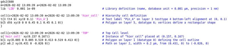

EDA tools can easily convert layout drawings like this one into the GDSII file format. The open-source GDS2GDT utility can then convert the layout from the GDSII format to the GDT text format. A GDT version of the above layout is shown in Figure 2.
GDT version of Figure 1.
Figure 2. GDT version of Figure 1.
A human-readable text format for GDS is a lot more convenient. It allows you to parse and manipulate the layout with ease by editing the coordinate positions of polygons, paths, and block instances. It also means that a simple, straightforward text diff can be used when comparing two layouts.

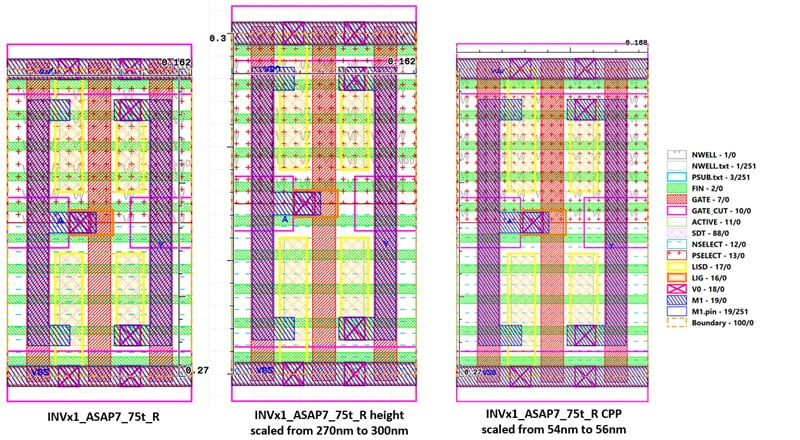

The 7.5 M1 track cell is of 270 nm height. To increase the cell height to 300 nm, all the shapes need to be scaled in the Y-direction by a factor of 10/9.
If we scale the gate pitch, the width of some layers will be unchanged, while other layers are scaled by a uniform factor. The example script in Table 2 stretches the gate pitch of the ASAP 7.5 track library from 54 nm to 56 nm.

Shapes in certain layers—gate, M1 metal, V1 VIA, and LISD, to give some examples—are only shifted, maintaining the widths. All other layers, including the N- and P-wells, fin region, and active region, are scaled by the factor 56/54. Figure 3 demonstrates the vertical and horizontal scaling for an inverter cell.
Original inverter layout (left), vertically scaled cell (center), and horizontally scaled cell (right).
Figure 3. Original inverter layout (left), vertically scaled cell (center), and horizontally scaled cell (right).
