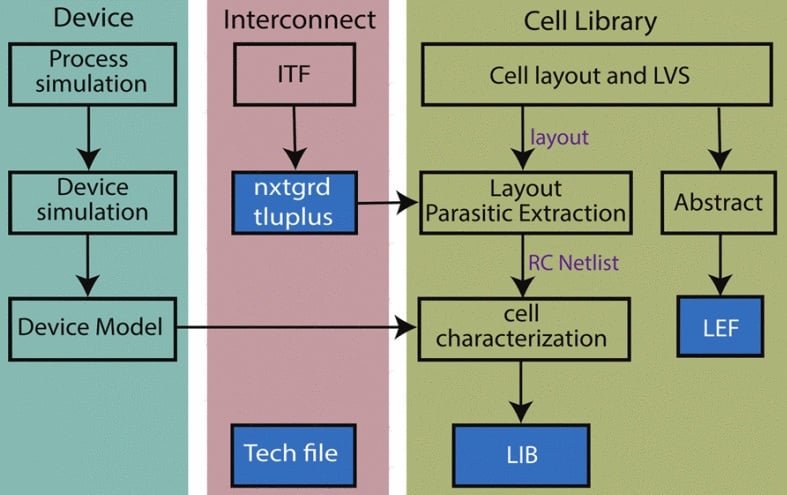

The next crucial step in PDK development is the design and development of N-channel and P-channel FET device models for the target technology. These models form the foundation of standard cell libraries, as we see in Figure 1.
PDK generation flow.
Figure 1. PDK generation flow. Image used courtesy of S. Shaji, et al.

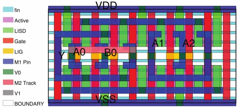

The final step is the development of a standard cell library. This must include electrical schematics for each cell that the user intends to include in the cell library. Figure 2 provides an example of a standard cell layout.
Cell layout for cell aoi31_x2.
Figure 2. Cell layout for cell aoi31_x2. Image used courtesy of X. Xu, et al.
Standard cell layouts are drawn compactly, confining intra-cell routing to the lower BEOL layers (typically M1–M3) and the MOL interconnects. The cell layouts are drawn by placing the various transistors in the schematic and routing the nets. While drawing the layouts, it's crucial to carefully study the process flow, lithographic limitations, and design rules.
Once drawn, layouts need to pass a layout-versus-schematic (LVS) check. First, layout netlist extraction detects devices, contacts, and wires. The LVS tool then compares the extracted netlist with the schematic. The layout is also checked for design rule violations during the Design Rule Check (DRC) step, ensuring it can be fabricated.
Not all the information in a layout is necessary for place-and-route simulation. The shapes defining the device intricacies and internal contacts are not typically used. Instead, abstracts of the layouts are extracted into LEF files for place-and-route simulation. The LEF includes the cell boundary, pins, intra-cell interconnects on metal layers available for routing, as well as layers needed to guide the placement of the cells.
