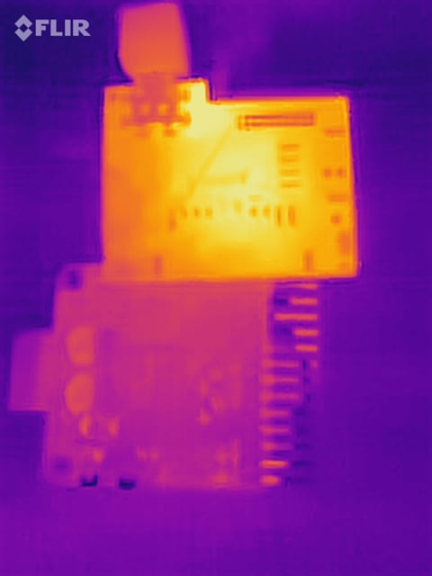

Most substances expand when heated and contract when cooled, but different materials have different thermal conductivity and different coefficient of thermal expansion and, consequently, they don’t expand or contract in a uniform way. Furthermore, printed circuit boards have localized sources of heat, such as a linear voltage regulator that must dissipate a large amount of power.
This FLIR camera image of two PCBs from a previous AAC project show the thermal differences between two connected PCBs.
Manufacturers that do not remove non-functional pads do so for customer satisfaction or mechanical reasons.  They believe that when the via shaft is bonded with as many layers as possible, it provides additional z-axis strength that resists the stresses of thermal expansion, which can cause cracks and separations in the via barrel.
