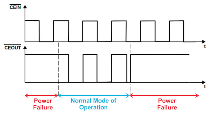

As shown in Figure 1, we can use the supervisory chip to control the chip-enable input of the SRAM, $$\frac{}{CE_{RAM}}$$, and put it in standby mode when required. Note that SRAMs need to draw only a small leakage current (less than about 10 μA) to retain the data at standby mode.
During a normal mode of operation, the supervisory chip passes all transitions of $$\frac{}{CE_{IN}}$$, which is controlled by the microcontroller, to $$\frac{}{CE_{OUT}}$$. Hence, normally, the supervisory chip is transparent and the MCU can enable/disable the SRAM. However, during a power failure, the supervisory chip sets $$\frac{}{CE_{RAM}}$$ to logic high to put the SRAM in the standby mode.
This is illustrated in Figure 3.
In the event of power failure, the SRAM is put in standby mode when the supervisory chip sets CE_RAM to logic high.
Figure 3. In the event of power failure, the SRAM is put in standby mode when the supervisory chip sets $$\frac{}{CE_{RAM}}$$ to logic high. Image (modified) used courtesy of Texas Instruments
Putting the SRAM in standby mode minimizes the power consumption in the battery mode. In this way, a typical BBSRAM can have a data retention of about 10 years.

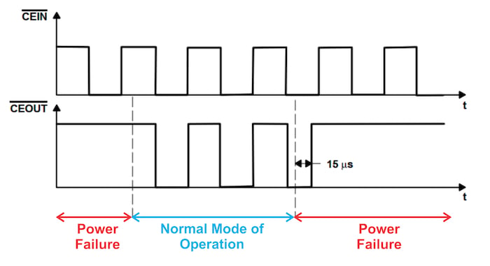

Note that many supervisory chips control their chip-enable output $$\frac{}{CE_{OUT}}$$ in a slightly different manner from that depicted in Figure 3.
For example, Figure 4 shows how the TPS3610 controls the SRAM chip enable.
Chip-enable timing of the TPS3610
Figure 4. Chip-enable timing of the TPS3610. Image (adapted) used courtesy of Texas Instruments
As you can see, the second power failure in the figure above occurs while $$\frac{}{CE_{IN}}$$ is logic low (the MCU has enabled the SRAM). In this case, the TPS3610 puts the SRAM into standby mode after a delay of 15 μs. This delay is implemented to allow a current potential write cycle to complete.
Supervisory chips from different manufacturers usually incorporate this delay; however, the value of the delay should be checked with the datasheet and can vary from about 10 μs to 15 μs.
