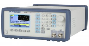

4079B Waveform Generator
BK Precision - 4075B Series
The 4075B Series Arbitrary/Function Waveform Generators combine a DDS architecture offering easy-to-use conventional function generator capabilities with a true point-by-point AWG architecture to produce accurate and precise arbitrary waveforms. Arbitrary waveforms have 14-bit amplitude resolution, 200 MSa/s sample rate, and large waveform memory up to 16,000,000 points (depending on model). Waveforms can be output in continuous, triggered, gated, or burst modes. The instrument can be remotely controlled using SCPI-compliant commands via USB and GPIB. Extensive features such as internal or external AM, FM, and FSK modulation along with versatile sweep capabilities and variable edge pulse generation make these generators suitable for a wide range of applications including electronic design, sensor simulation, and functional test.
  • Frequency: 1 µHz to 50 MHz
  • Channels: 2
  • Form Factor: Benchtop
