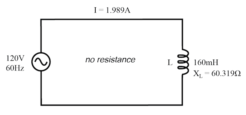

Reactive Load Only
True power, reactive power, and apparent power for a purely reactive load.
$$\text{True Power} = P = I^2R = 0 \text{ W}$$
$$\text{Reactive Power} = Q = I^2X = 238.73 \text{ VAR}$$
$$\text{Apparent Power} = S = I^2Z = 238.73 \text {VA}$$

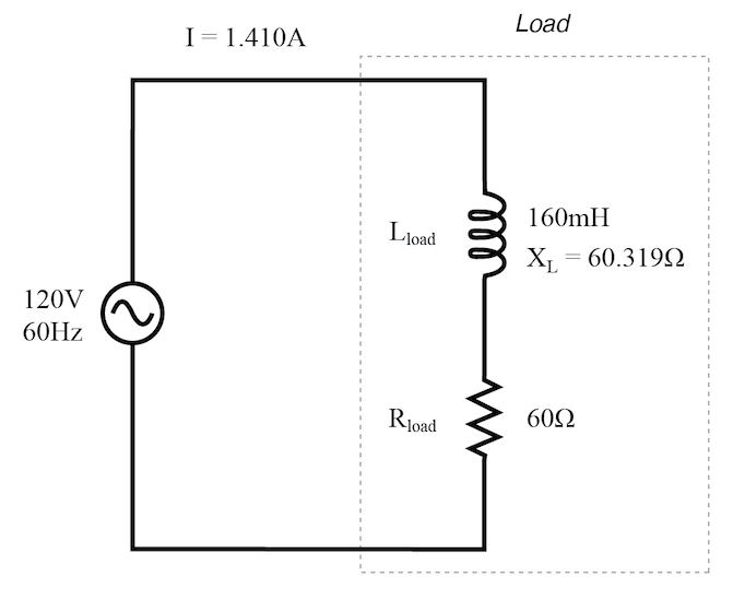

Resistive/Reactive Load
True power, reactive power, and apparent power for a resistive/reactive load.
$$\text{True Power} = P = I^2R = 119.365 \text{ W}$$
$$\text{Reactive Power} = Q = I^2X = 119.998 \text{ VAR}$$
$$\text{Apparent Power} = S = I^2Z = 169.256 \text {VA}$$
