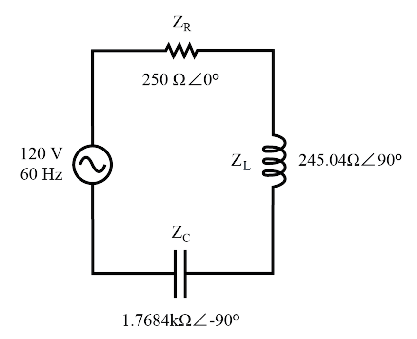

Let’s take the following example circuit and analyze it:
Example series R, L, and C circuit.
Solving for Reactance
The first step is to determine the reactance (in ohms) for the inductor and the capacitor.
solving for reactance
The next step is to express all resistances and reactances in a mathematically common form: impedance. (Figure below)
Remember that an inductive reactance translates into a positive imaginary impedance (or an impedance at +90°), while a capacitive reactance translates into a negative imaginary impedance (impedance at -90°). Resistance, of course, is still regarded as a purely “real” impedance (polar angle of 0°):
express all resistances and reactances in a mathematically form
Example series R, L, and C circuit with component values replaced by impedances.

Since the above example circuit is a series circuit, we know that the total circuit impedance is equal to the sum of the individuals, so:
Inserting this figure for total impedance into our table:

Notice something strange here: although our supply voltage is only 120 volts, the voltage across the capacitor is 137.46 volts! How can this be? The answer lies in the interaction between the inductive and capacitive reactances.
Expressed as impedances, we can see that the inductor opposes current in a manner precisely opposite that of the capacitor. Expressed in rectangular form, the inductor’s impedance has a positive imaginary term and the capacitor has a negative imaginary term.
When these two contrary impedances are added (in series), they tend to cancel each other out! Although they’re still added together to produce a sum, that sum is actually less than either of the individual (capacitive or inductive) impedances alone.
It is analogous to adding together a positive and a negative (scalar) number: the sum is a quantity less than either one’s individual absolute value.
If the total impedance in a series circuit with both inductive and capacitive elements is less than the impedance of either element separately, then the total current in that circuit must be greater than what it would be with only the inductive or only the capacitive elements there.
With this abnormally high current through each of the components, voltages greater than the source voltage may be obtained across some of the individual components! Further consequences of inductors’ and capacitors’ opposite reactances in the same circuit will be explored in the next chapter.
