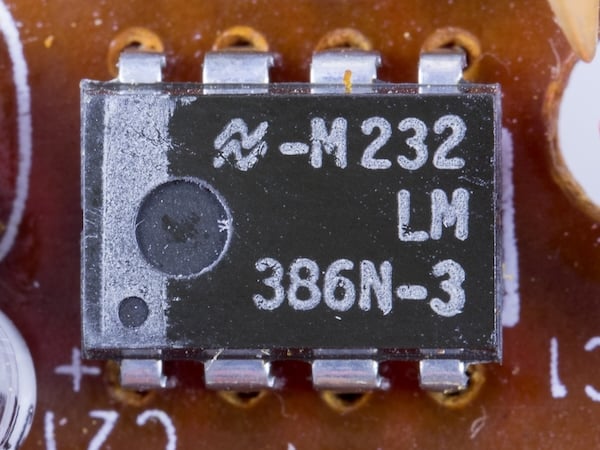

An LM386 in a DIP-8 package. Image used courtesy of Raimond Spekking via Wikimedia Commons (CC BY-SA 4.0)

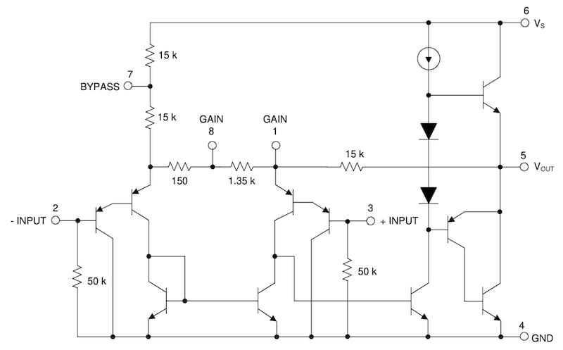

The LM386's internal circuit (datasheet linked) follows the Lin topology that was already standard in discrete audio amplifier design: a differential input stage, a voltage amplifier stage, and a complementary push-pull output. It compressed that entire signal chain into a package smaller than a fingernail.
The input stage uses a PNP emitter-follower pair feeding a long-tailed differential amplifier. Two 50-kΩ resistors set the input impedance and provide the ground-reference path, allowing the inputs to accept signals at or near ground potential without external biasing.
Schematic of the LM386
Schematic of the LM386. Image used courtesy of Texas Instruments
The gain network sits between pins 1 and 8: an internal 1.35-kΩ resistor in series with a 150-Ω resistor fixes the default voltage gain at 20 (26 dB). Placing a capacitor across pins 1 and 8 bypasses the 1.35-kΩ resistor and pushes the gain to 200 (46 dB), while a resistor in series with that capacitor sets any value in between. The output stage is a complementary push-pull pair biased into Class AB, capable of driving loads from 4 Ω to 32 Ω . The output automatically biases to half the supply voltage, eliminating any need for external DC biasing.

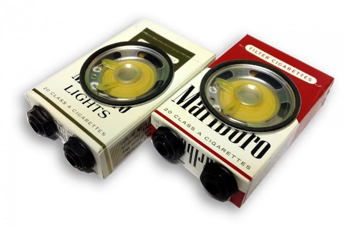

The chip's second and longer life came in the DIY community. Bruce Zinky, an American electronics engineer who headed Fender's amplifier custom shop, designed the Smokey Amp in the early 1980s: a complete guitar amplifier using one LM386 and two capacitors, built to fit inside a cigarette pack. The design had no controls at all, with volume and tone set entirely from the guitar's own inputs.
The Smokey Amp
The Smokey Amp, designed by Bruce Zinky. Image used courtesy of Audiofanzine
Zinky improved it for commercial production in the 1990s, and the Smokey Amp went on to become one of the most widely cloned circuits in hobbyist electronics. The "Little Gem" and "Little Gem MkII" are direct derivatives, and dozens of other LM386-based mini amps, fuzz circuits, code-practice oscillators, and Arduino speaker drivers have followed.
