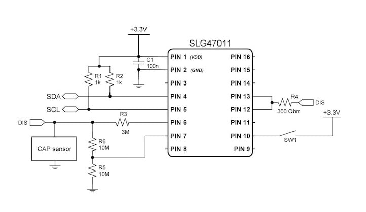

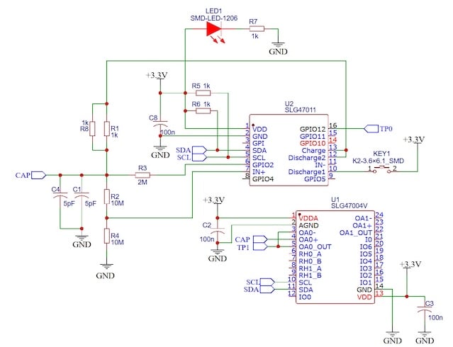

Circuit Connection
To understand the design, let’s first examine the connection diagram for the capacitance measurement application. Figure 1 shows the circuit where the capacitive sensor is charged through the 3 MΩ resistor R3 and discharged through the 300 Ω resistor R4. The SW1 button is used for the initial capacitance calibration. Resistors R5 and R6 are DNP and are used in cases where the max signal on the capacitive sensor exceeds a voltage higher than 1.6 V.
Figure 1 Circuit connection.
Figure 1. Circuit connection.

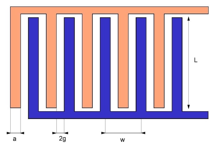

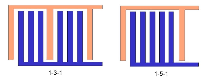

Fringing Field Capacitance Sensor for Liquid Level Measurement
A fringing field capacitive sensor uses the electric field extending beyond the edges of electrodes to detect changes in the dielectric constant of the surrounding environment. Unlike traditional parallel plate capacitors where the field is confined between plates, this sensor works based on coplanar interdigitated electrodes placed on a dielectric surface. When an alternating voltage is applied between the working and sensing electrodes, the electric field lines spread outward and penetrate the material near the electrodes. This penetration allows the sensor to measure properties such as the liquid level without direct contact. Figure 2 shows the structure of the fringing field capacitance sensor.
Figure 2 Configuration and geometry of the electrode used in fringingfield capacitance sensors (blue is the sensing electrode and orange is theworking electrode).
Figure 2. Configuration and geometry of the electrode used in fringing field capacitance sensors (blue is the sensing electrode and orange is the working electrode).

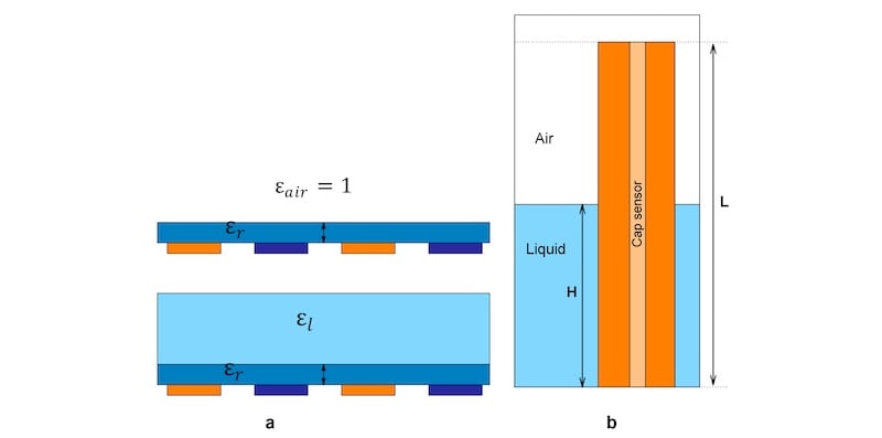

Figure 2 illustrates a coplanar interdigitated electrode sensor used for non-contact liquid level measurement. The sensor (see Figure 4) consists of equally spaced fingers on the working and sensing electrodes with gap (2g), finger length (L), width (α), and wavelength (w). It is placed against a dielectric sample of relative permittivity (ετ)and height (H). Electrodes are excited by potential +/- V, generating an electric field penetrating the dielectric, with maximum field penetration (h).
In addition to the configuration shown on Figure 2, there may be other possible designs of the 1-n-1 type, where n is the number of sensing electrodes. Some of the other possible configurations are shown in Figure 3.
Possible electrode configuration for fringing field capacitance sensor
Figure 3. Possible electrode configuration for fringing field capacitance sensor

As the liquid height H increases, the portion of the field passing through the liquid grows, but we also have a portion of the electric field passing through air. So, two capacitances are formed and the total capacitance equals the sum of the capacitance of the liquid level (CH) and the capacitance of the air (CA). Figure 4 shows the representation of this model where ετ and εl are the dielectric constants of the container wall and liquid, respectively. A simple representation of the total capacitance can be expressed as:

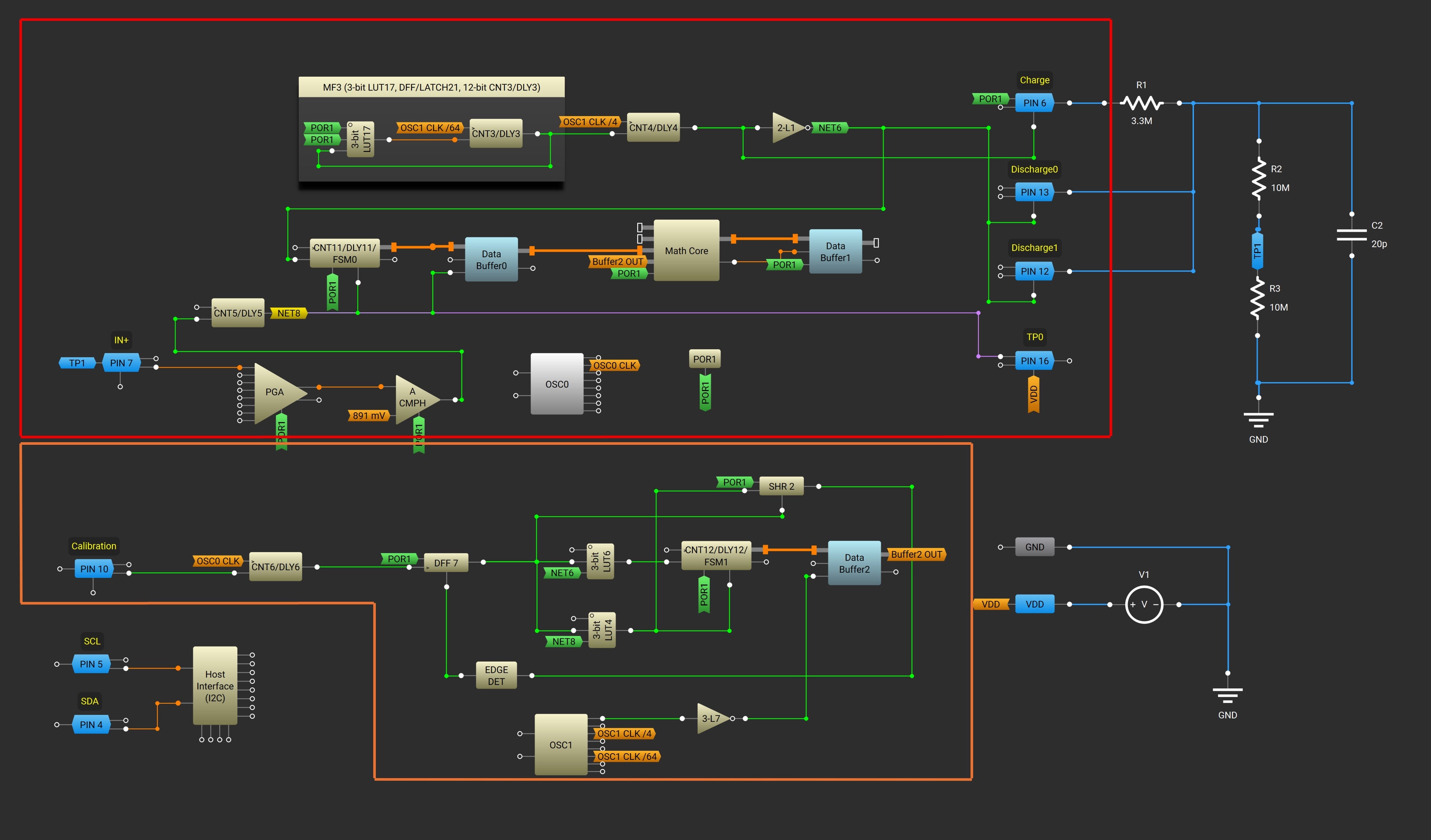

Design for Liquid Level Measurement
The operating principle of this design is based on the alternating charging and discharging of the capacitive liquid level sensor and measuring the changes in the time constant (τ). The design is shown in Figure 5.
Figure 5. Design for liquid level measurement.
Figure 5. Design for liquid level measurement. (Click on image to enlarge)
It consists of two main parts:
The main part of the design (highlighted in red in Figure 5) implements the sequential charging and discharging cycles of the sensor and performs the capacitance measurement.
Let’s take a closer look at how this part works.

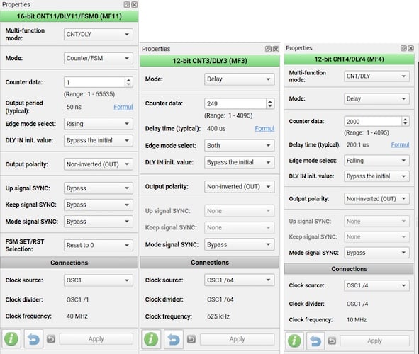

LUT7 and DLY3 form a frequency generator. Since the time constant measurement is performed only on the rising edge, DLY4 is used to introduce a delay on the falling edge. This increases the duration of the high-level signal, which increases the measurement frequency since we can save time on the duration of the low level. The signal generated is applied to the output pins configured in tri-state mode.
During charging, PIN6 outputs a high level, and the capacitive sensor is charged through a 3 MΩ resistor. PIN12 and PIN13 remain in a Hi-Z state during this process.
During discharging, PIN12 and PIN13 output a low level, and the sensor discharges through a 300 Ω resistor, while PIN6 switches to a Hi-Z state.
To measure the time constant, FSM0 is used. At the start of a new charging cycle, FSM0 is reset to its initial value and begins counting clock cycles. Since FSM0 operates from a 40 MHz oscillator, one counter increment corresponds to 25 ns.

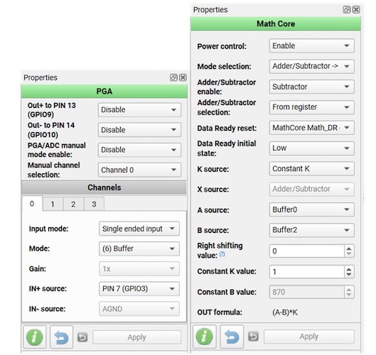

The signal generated on the sensor during charging / discharging is fed to the PGA through PIN7. The PGA block configuration is shown in Figure 6. The signal from the PGA is then sent to the comparator. When the voltage reaches the threshold corresponding to the 1τ or 2τ, the comparator output switches to “0,” stopping FSM0 and triggering data storage into Buffer0 and Buffer1. The ACMP threshold can be adjusted via I2C by writing data to the 0x19E register. The threshold can range from 27 to 1620 mV with a 27 mV step.

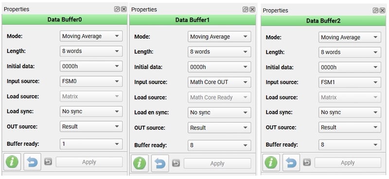

The value from Buffer is then read and multiplied by 25 ns to convert it into the time constant. Since we know the resistor value, the sensor’s capacitance or its variation can be calculated.
The second part of the design (highlighted in orange in Figure 5) is used for calibrating the initial capacitance. The calibration works as follows: after the button connected to PIN10 is pressed, the output of DFF7 switches to a high level. DLY6 in this case acts as a filter, preventing false triggering from occurring.
When DFF7 is set to a high state, FSM1 operates in parallel with FSM0 during the next charging cycle of the capacitive sensor. The SHR2 block counts the number of completed charge-discharge cycles and after eight cycles, Buffer2 will be fully filled, and DFF7 will reset to its initial state. The averaged value stored in Buffer2 is subtracted from the measured value stored in Buffer0 in the Math Core.
PGA and Math core configuration
Figure 6. PGA and Math core configuration
Data Buffer configuration
Figure 7. Data Buffer configuration
DLY 3, 4 and FSM configuration
Figure 8. DLY 3, 4 and FSM configuration

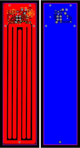

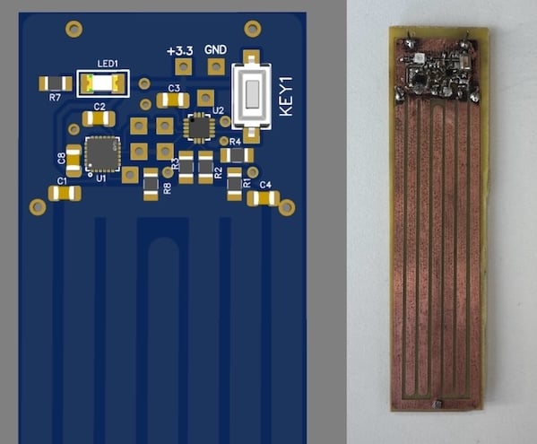

According to the schematic, a demonstration board was created for measuring the liquid level using a non-contact method. This board is shown in Figure 10 and Figure 11.
Figure 10. Demonstration board for measuring liquid level using thecapacitive method.
Figure 10. Demonstration board for measuring liquid level using the capacitive method.
Test demo board
Figure 11. Test demo board

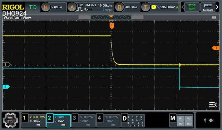

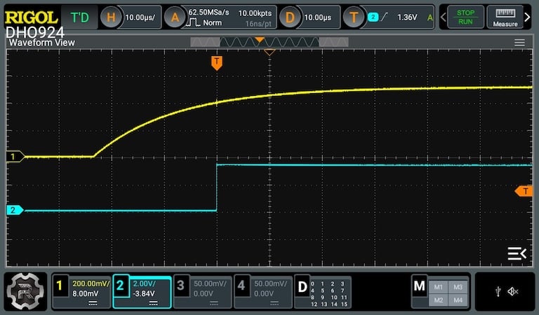

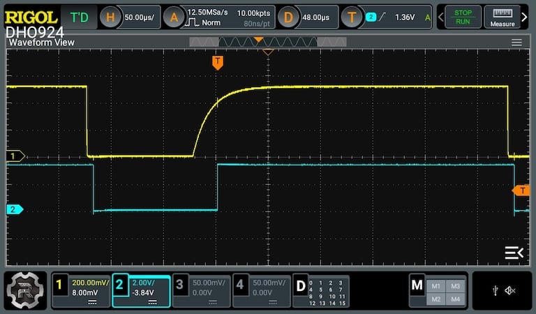

The design was tested in hardware and the following waveform results were obtained: CH1 (yellow) – signal on the capacitive liquid level sensor. CH2 (blue) – output signal from the ACMP. The transition from LOW to HIGH occurs when the signal on the capacitive sensor reaches the threshold level at 1τ.
Discharging and charging cycle
Figure 12. Discharging and charging cycle
Zoomed charging
Figure 13. Zoomed charging

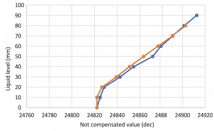

Using the demonstration board described in Section 5, the following results were obtained.
Figure 15 shows a graph illustrating the dependence of the subtracted code from the AnalogPAK device on the liquid level height. In this graph, the orange line represents the data measured when the container is being filled, while the blue line represents the data when the container is being emptied. Each point on the graph corresponds to the averaged value of 100 measurements at a constant liquid level.
It is worth noting that the length of the sensor itself is 10 cm. From this graph, it can be seen that this dependence is almost linear across the entire range, which corresponds to theoretical expectations.
Figure 15. Dependency of read value from the SLG47011 whichcorresponds to capacity vs. liquid level.
Figure 15. Dependency of read value from the SLG47011 which corresponds to capacity vs. liquid level. Orange line indicates container filling, blue indicates emptying
