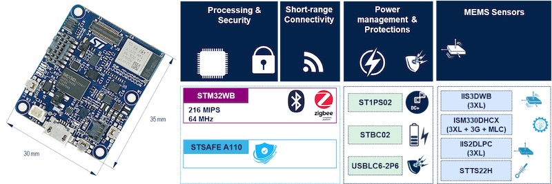

The STEVAL-PROTEUS1 kit is an evaluation tool designed for temperature and vibration monitoring in industrial applications. The main board (STEVAL-PROTEUS, Figure 3) includes a certified wireless radio module, a combination of industrial MEMS inertial sensors to enable vibration monitoring, a high-accuracy temperature sensor, power management and protection circuits, and 2 Gb of flash memory for code and data storage.
The board also offers an STSAFE-A110 secure element that provides authentication and secure data management services to a local or remote host. All the components are mounted exclusively on the top side of the PCB to facilitate direct attachment.
The wireless module, STM32WB5MMG, has a small form factor with ultra-low power consumption and an STM32WB55VGY wireless SoC. The SoC contains a 2.4 GHz integrated RF section with an Arm Cortex-M4 core for application processing and a Cortex-M0+ to manage the radio layer. The M0+ can host stacks such as Bluetooth Low Energy (BLE) 5, 802.15.4, Zigbee 3.0, Thread, or proprietary software.
The STEVAL-PROTEUS board
Figure 3. The STEVAL-PROTEUS board

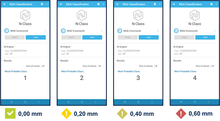

We attached the STEVAL-PROTEUS node to the second bearing as shown in Figure 10. The motor speed was set to 3000 rpm. Testing then introduced progressively greater misalignment of the bearing shaft, keeping other experimental parameters identical. The PROTEUS node recognized misalignment correctly in all four categories and communicated the results to the smartphone app.
The results, as shown on the mobile app
Figure 11. The results, as shown on the mobile app. Click image to enlarge
As Figure 11 shows, the mobile app displays a number corresponding to the recognized condition. The app also takes care of sharing the results with the cloud.
Further testing to apply other motor faults using the same procedure to generate appropriate ML libraries, showed that inferencing with the PROTEUS node can also correctly recognize normal and unbalanced loads, mechanical looseness, and bearing faults.
