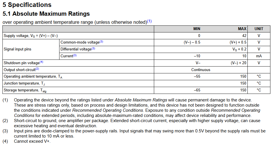

The acceptable approach will help mitigate EOS events, but since there are internal diodes in the amplifier, it’s important to leverage them carefully to prevent damage to the op amp. In the TI OPA992, OPA2992 and OPA4992 op amp data sheet, the absolute maximum ratings table (Figure 4) includes what input currents are considered safe.
An excerpt from the OPA992, OPA2992 and OPA4992 absolute maximum ratings table.
Figure 4. An excerpt from the OPA992, OPA2992 and OPA4992 absolute maximum ratings table. (Click image to enlarge)
The data sheet specifies that the input voltage must be limited to within 0.5 V of V+ or V–, and must not exceed 10 mA sinking or sourcing. Additionally, the supply voltage must not exceed 42 V of potential difference between the two supply pins.

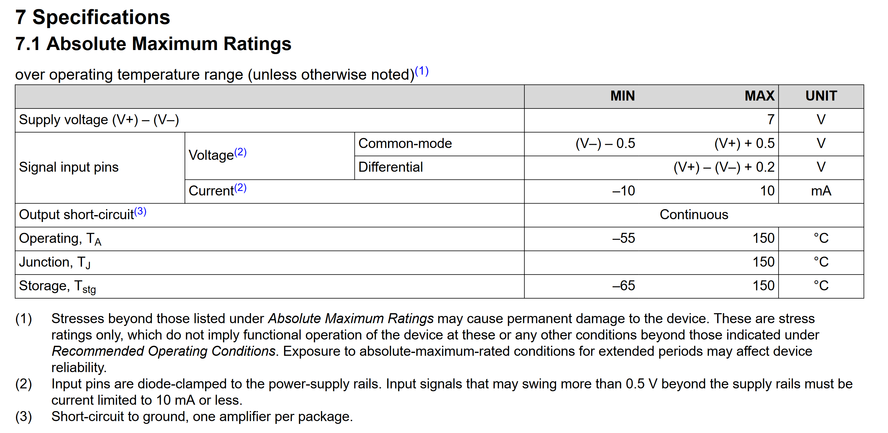

With a supply voltage of 5 V, the difference between a 12 V short condition and the 5 V amplifier supply is 7 V. To keep this short condition from sourcing more than 10 mA into the amplifier, you need 700 Ω on the input of the amplifier. And to keep this current under 1 mA, you need 7 kΩ. Adding a standard and common resistor value, placing a 10 kΩ series resistor on the input of the amplifier should limit the current to a safe level. To confirm that this series resistor will protect the op amp, see the absolute maximum ratings of the TI TLV9002, shown in Figure 7.
Excerpt from the absolute maximum ratings table for the TLV9002 op amp.
Figure 7. Excerpt from the absolute maximum ratings table for the TLV9002 op amp. (Click image to enlarge)
Adding a Zener diode from VCC to ground, with a reverse voltage of 6 V, will keep the op amp supply pin from exceeding a supply voltage above the absolute maximum rating of 7 V. In cases where the supply can source and sink current, the supply rail will be able to properly regulate and protect the supply voltage of the amplifier without the need for a Zener diode.
You must also consider the input voltage, which is limited between (V–) –0.5 V and (V+) +0.5 V. A short-to-12V VBAT condition does violate the input-voltage limitation; however, there is a footnote in Figure 7 that specifies that if the input signal is outside the supply rails, it must be limited to 10 mA or less. The ability to meet this condition greatly reduces the likelihood of damage and does not violate the ratings in the absolute maximum table.
