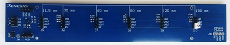

Remote Sense Mode for PCBs with Long Traces
Another use case for using Remote Sense mode is when the load is located far from the IC on the PCB. At higher currents, the voltage drop becomes more noticeable depending on the VOUT trace length, width, and copper area used.
A test board with different trace lengths is shown in Figure 9. The SLG51003 is configured with the same settings as in the previous test setup with the FFCs.
Test setup for comparing LDO regulation across PCB traces of varying
lengths.
Figure 9. Test setup for comparing LDO regulation across PCB traces of varying lengths.

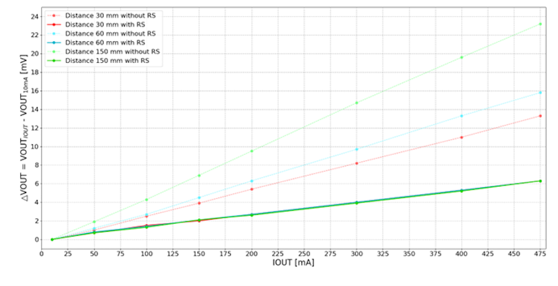

Table 2 shows that as the trace length increases, the voltage drop across the load without Remote Sense also increases.
Table 2. Comparison of the voltage drop with/without Remote Sense for two load currents and various PCB trace lengths.
Trace Length (mm) 30 60 150
Trace Resistance (mΩ) 27.7 33.1 48.3
  Without Remote Sense
VOUT @ 10 mA 2.851 V 2.851 V 2.851 V
VOUT @ 475 mA 2.838 V 2.835 V 2.828 V
Voltage Drop 13.3 mV 15.8 mV 23.2 mV
  With Remote Sense
VOUT @ 475 mA 2.845 V 2.845 V 2.845 V
Voltage Drop 6.3 mV 6.3 mV 6.3 mV
Without Remote Sense, the voltage sags by tens of millivolts at the maximum current of 475 mA. However, the difference can be compensated for thanks to the Remote Sense mode function. The output voltage drop when using Remote Sense mode is the same for each given distance and significantly smaller than without this function.
Figure 10 plots the load voltage difference (∆VOUT) for different PCB trace lengths. The voltage difference is calculated between the voltage at 10 mA load and other load current points.
Line chart showing changing in load voltage versus PCB trace length
with and without Remote Sense
Figure 10. LDO1 comparison of the voltage drop with/without Remote Sense for different PCB trace lengths.
This figure clearly indicates that the Remote Sense mode successfully compensates for the voltage drop on the trace.
