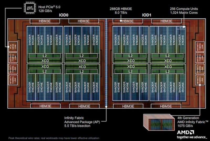

AMD’s first big release is its Instinct MI350 Series GPU, the first to implement the company’s CDNA 4 architecture. Built on TSMC’s N3P node, the MI350X and MI355X incorporate a 3D hybrid-bonded XCD die stacked atop a 6-nm IOD, yielding a compact chiplet footprint. Each GPU features 256 compute units and 1,024 matrix cores, with support for mixed precision formats including FP16, BF16, FP8, and new microscaled FP6 and FP4 types. As a result, the MI355X can deliver up to 10 PFLOPs of sparse FP8 matrix performance, with support for FP4 extending performance to 20 PFLOPs—nearly double the throughput of MI300X.
AMD’s Instinct M1350 Series GPU
AMD’s Instinct M1350 Series GPU.
The architecture includes 288 GB of HBM3E memory across eight stacks, achieving 8 TB/s of memory bandwidth. AMD also doubled the unified translation cache (UTC) capacity and optimized the memory subsystem to boost read bandwidth per watt by 1.3x over the previous generation. Meanwhile, partitioning options such as CPX+NPS2 enable a single MI355X to simultaneously serve eight instances of LLaMA 3.1 70B models, while SPX+NPS1 mode supports up to 520 billion parameters per GPU.
