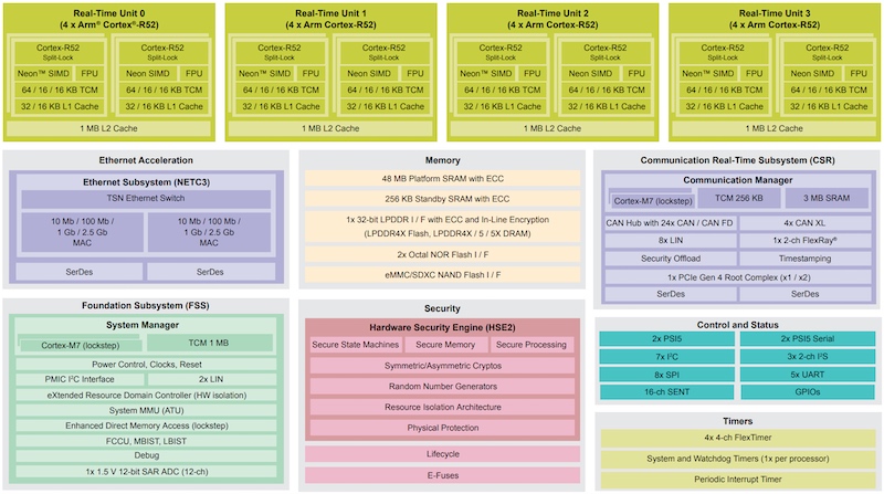

NXP announced the first member of its new S32N vehicle processors. The S32N55 is designed to integrate multiple engine control units (ECU) into one software-defined vehicle (SDV) system. The S32N55 enables designers to dynamically configure hardware isolation for critical functions traditionally controlled in separate ECUs. This separation of functions into discrete ECUs maintains adequate system isolation. You can’t have a bug in the infotainment system bringing down the engine fuel control.
The vast number of automotive systems needing electronic control has led to abundant discrete ECUs in today’s cars. More ECUs require more space and more power—and entail more potential points of failure. The NXP S32N family of vehicle processors is designed to mitigate this problem by integrating multiple ECU functions into one processing unit, called super-integration.
S32N55 block diagram
S32N55 block diagram. Image used courtesy of NXP Semiconductors (Click to enlarge.)
The family is powered by 16 real-time split-lock Arm Cortex-R52 cores, running at 1.2 GHz. The chip can support compliance with ISO 26262 ASIL-D safety levels by operating in either split or lockstep modes, allowing for super-integration without compromising safety. It also contains two Cortex-M7 cores for overall system operations and communications. It has 49 MB of tightly integrated SRAM and can be expanded with LPDDR4X/5/5X DRAM, LPDDR4X Flash, and NAND/NOR Flash memory. It communicates with the outside world via a time-sensitive networking (TSN) 2.5 Gbit/s Ethernet switch, CAN hub, four CAN XL interfaces, and a Gen 4 PCI Express interface, and is capable of over-the-air (OTA) upgradability.
The S32N processor family fits into NXP’s Open S32 CoreRide Platform. CoreRide is a development platform that customizes automotive electronics in software. NXP refers to this as a software-defined vehicle (SDV) system. CoreRide, with the S32N processors, allows one set of hardware to be configured in multiple ways to support different types of vehicles and different combinations of infotainment, navigation, climate control, and system control.

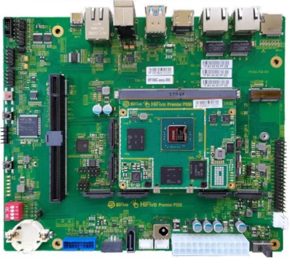

Also announced at Embedded World 2024 was the HiFive Premier P550 development board from SiFive. The new RISC-V board, promoted as the highest-performing RISC-V development board, is a development environment for SiFive’s Performance P550 processor, which features out-of-order processing in a RISC-V architecture.
Out-of-order processors split instructions into three steps: instruction fetch, instruction dispatch, and instruction queue. Instructions wait in the queue until their operands are available, at which time they are sent to the appropriate processor section to be operated upon. This means that if the input is ready, an instruction may be operated on prior to other instructions that have been in the queue longer. This speeds up program execution by not waiting for non-dependent prior operations.
HiFive Premier P550 development board. Image used courtesy of SiFive
The quad-core P550 processor integrates this capability into SiFive’s RISC-V IP, and the new development board makes the processor available to developers now. The board runs Ubuntu and is designed with a system-on-module (SoM) architecture for flexible implementation and upgrading.
Key features of the P550 processor include:
  • Quad-core SiFive Performance P550 64-bit RISC-V processor
  • Three-issue out-of-order capability
  • 256 KB L2 cache and 4 MB L3 cache
  • 2D/3D GPU, hardware video encoder/decoder
  • NPU, DSP, and MIPI DSI
  • Integrated high-speed DDR5 memory controller
  • Root complex PCI Express Gen 3 x4
The development board comes with 6 GB of 64-bit LPDDR5-6400 memory, 128 GB of eMMC memory for fast boot, PCI Express Gen3 x4 (1 PCIe x16 slot), 5x USB 3 ports, the Ubuntu OS,  and Freedom U-SDK.

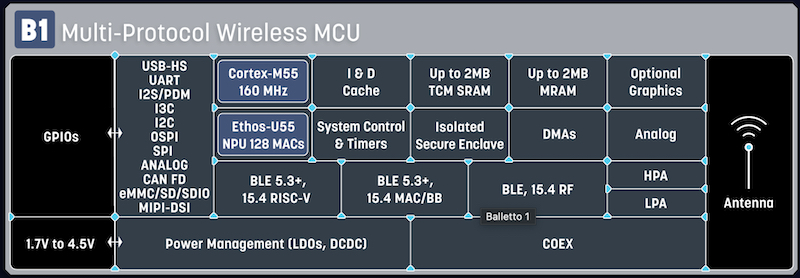

Alif Semiconductor announced the "world’s first BLE and Matter wireless microcontroller" to feature neural co-processors for AI/ML workloads. The BLE 5.3 chips, called the Balletto family, target home automation and Matter protocol systems. Matter is a universal protocol that supports wireless home automation devices from multiple manufacturers.
Balletto family
The ultra-low-power BLE MCU. Image used courtesy of Alif Semiconductor
Home automation contains a mix of line voltage, battery, or solar-powered devices. In many applications, size is limited. Alif added native AI processing to this device while keeping size and power draw low. The Balletto family of BLE MCUs selectively powers off-chip sections when unused to maintain ultra-low power consumption.
Native AI may seem excessive for small, low-power devices, but it is becoming increasingly important for critical decision-making. To this end, the chip is powered by an Arm Cortex-M55 CPU and an Arm Ethos-U55 neural processing unit (NPU). The NPU, backed by tightly coupled memory (TCM), can perform up to 46 GOP/s. It extends the audio capabilities with hardware-accelerated AI/ML models.
The neural processor performs 15x better than a non-neural Cortex-M4. It has an analog front-end with high-precision ADCs, including a 24-bit sigma-delta, DAC, an Octal SPI interface, and up to 77 GPIO. Versions can have up to 2 MB of high-speed MRAM and 2 MB of zero-wait state SRAM.
The Balletto processors share architecture with Alif’s Ensemble family, so developers familiar with one family can easily move to the other.
