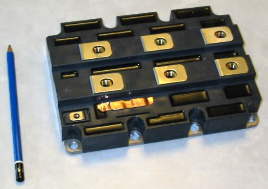

IGBT module
IGBT module. Image (modified) used courtesy of Wikimedia Commons and ArséniureDeGallium (CC BY-SA 3.0)
After his time at Rensselaer, Baliga took a position at General Electric’s Research and Development Center in 1974 and got to work developing the IGBT. His team was challenged to develop a better semiconductor switch than was available at the time. Within a month, Baliga had a patent disclosure ready for the IGBT.

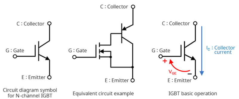

The IGBT is a three-terminal power semiconductor switch. It is constructed as a low-loss bipolar junction switching semiconductor controlled by a metal oxide gate region, making it significantly more efficient at switching high voltage and high current than any viable alternatives.
IGBT structure
The IGBT is roughly equivalent to a circuit consisting of a MOSFET and a bipolar PNP transistor. Image used courtesy of Rohm Semiconductor
The IGBT does not latch like a thyristor and offers amplification and digital switching. Today, the IGBT is the second most common power transistor in the world after the MOSFET. While MOSFETs have become extremely power-efficient, fast, and versatile devices, the IGBT performs better in the high-current, high-voltage regimes.
The IGBT gate-drive control methodology is very similar to that of the MOSFET, making it easy to design in when appropriate. The switching mode works like a bipolar transistor, giving it the ability to handle high voltages and currents. It is easier to run many IGBTs in parallel than MOSFETs. While a set of MOSFETs in parallel, if not carefully designed, can end up throwing excess current through the weakest part, IGBTs inherently spread the load. Further, the IGBT typically has a lower forward voltage drop than high-power/high-current MOSFETs.
These characteristics put the IGBT into power controls that run at household line voltages and higher. Home washing machines, refrigerators, HVACs, and induction cooking ranges are now commonly controlled with IGBT-based electronics. In industrial applications, traction motors, power supplies, and anything requiring high power control up to hundreds of kilowatts can be controlled with banks of IGBTs.
