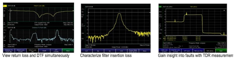

DTF and TDR in Single Sweep
Keysight claims the FieldFox is the only handheld instrument that can measure both DTF and TDR in a single sweep.
