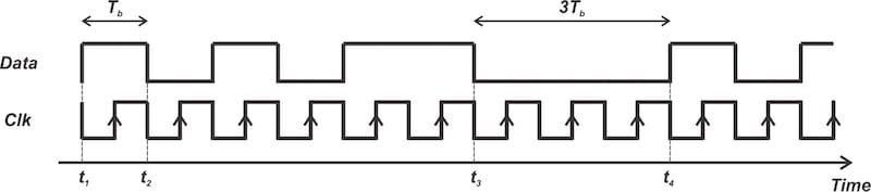

The bottom waveform in Figure 2 illustrates the ideal clock for our example, with the assumption that the rising edges of the clock serve as the sampling edges.
Input data waveform (top) and desired clock signal (bottom).
Figure 2. Input data waveform (top) and desired clock signal (bottom).
A sequence of consecutive ones or zeros in the data waveform is known as a 'run.' In the data waveform, there is a run of 3 bits from t3 to t4. The lack of transitions during this interval indicates that no frequency or phase information is present. How can the CDR circuit generate a periodic clock from the data waveform that lacks periodic transitions and doesn't provide phase or frequency information during its runs?
The CDR circuit needs to leverage the transitions in the data waveform to create a clock with a period of Tb and an appropriate phase alignment with the input data. During a run in which no frequency or phase information is available, the CDR circuit should maintain the previously acquired clock frequency and phase.
Note that long runs complicate CDR design. In practice, data is encoded to impose an upper limit on run length, as specified by the communication standard.

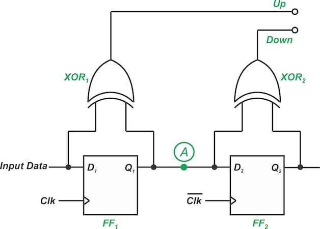

Shown in Figure 3 is the Hogge phase detector. You might remember this circuit from our discussion of the RS flip-flop phase detector.
Hogge phase detector circuit.
Figure 3. The Hogge phase detector.
In the Hogge detector, two distinct sections process the input data. The first section (FF1 + XOR1) samples the data stream on rising clock edges and XORs it with the delayed input to generate Up pulses. The second section (FF2 + XOR2) resamples FF1's output on falling edges and XORs it with FF1's output to create Down pulses. Together, the Up and Down paths provide the phase error information needed for clock recovery.

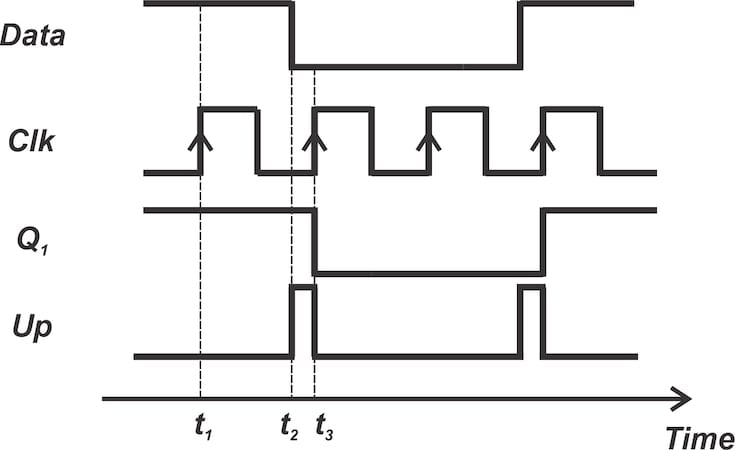

To comprehend the workings of the Hogge detector, let's begin by looking at the first section of the circuit in Figure 3 (FF1 and XOR1). The waveforms in Figure 4 will aid in this understanding.
Waveforms for the first section of the Hogge detector.
Figure 4. Waveforms for the first section of the Hogge detector.
A D flip-flop captures the input value at the sampling edge of the clock and maintains it at the Q output until the next sampling edge. The Hogge detector leverages this data storage capability to compare the current data value with the previous sample held in the flip-flop to detect data transitions. In the waveforms presented here, we assume that the initial value stored in the flip-flop is a logic HIGH.
The flip-flop samples the input and updates the Q output at each rising edge of the clock. At time t = t1, the input is logic-HIGH; at t = t3, it's logic-LOW. Consequently, the output Q1 remains HIGH at t = t1 and transitions to a logic LOW at t = t3.
The input data and the flip-flop output are applied to the XOR gate. The XOR compares the last sample with the current data value, generating a pulse that starts at the moment of the data transition and ends at the rising edge of the clock. Thus, the width of the pulse indicates the phase difference between the input data and the clock.

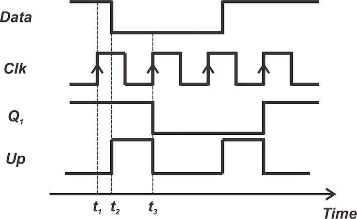

To illustrate this, compare the waveforms above with those displayed in Figure 5. In the new waveforms, the data transition takes place closer to t = t1, resulting in wider pulses at the Up output.
Waveforms that produce wider pulses at the Up output.
Figure 5. These waveforms produce wider pulses at the Up output.
To summarize, the combination of FF1 and XOR1 detects transitions in the input data, generating a positive pulse at the output of the XOR gate for each data transition. The width of these pulses depends on the timing difference between the input data transition and the sampling edge of the clock.

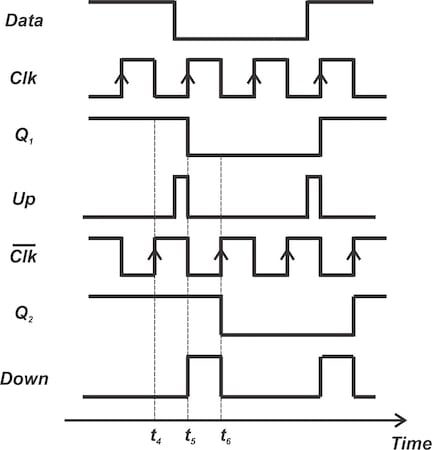

Role of the Second Flip-Flop and XOR Gate
The Hogge detector's second section consists of FF2 and XOR2. From our earlier discussion, we understand that these two components work together to detect transitions at node A, creating a positive pulse at the XOR gate's output for each data transition. But what is the pulse width?
It's essential to recognize that transitions at node A occur at the rising edges of the clock due to the first flip-flop's operation (see Figures 4 and 5). However, the output of the second flip-flop (FF2) changes at the falling edges of the clock. Consequently, transitions at node A always take place half a clock period before the sampling edge of FF2. As illustrated in Figure 6, this means the pulses generated at the Down output have a fixed width equal to half the clock period.
Operation of the Hogge detector's second section.
Figure 6. Waveforms illustrating the operation of the second section of the Hogge detector.

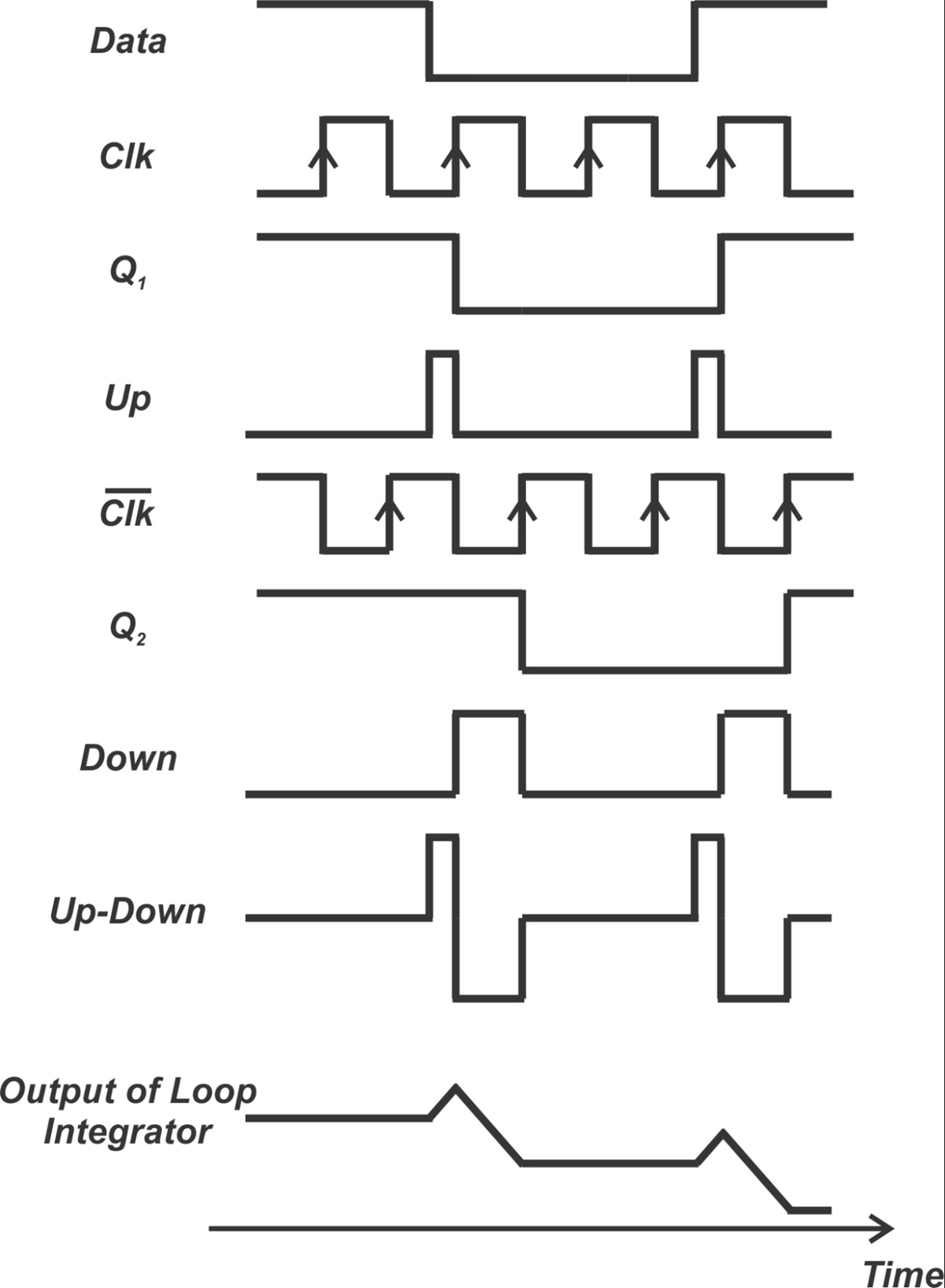

The phase error can be determined by comparing the widths of the Up and Down pulses. To produce a signal that reflects the phase error, we subtract the Down pulse from the Up pulse and then integrate the result. In practice, the subtraction and integration functions can be achieved simply by applying Up and Down signals to a charge pump. Figure 7 shows the Up-Down signal and its integral for our example waveforms.
Waveforms illustrating the final output of the Hogge detector.
Figure 7. [click to enlarge] Waveforms illustrating the final output of the Hogge detector.
In this scenario, the Up pulses are narrower than the Down pulses. As a result, the average value of Up-Down is negative, leading to a decrease in the output of the loop integrator over time.

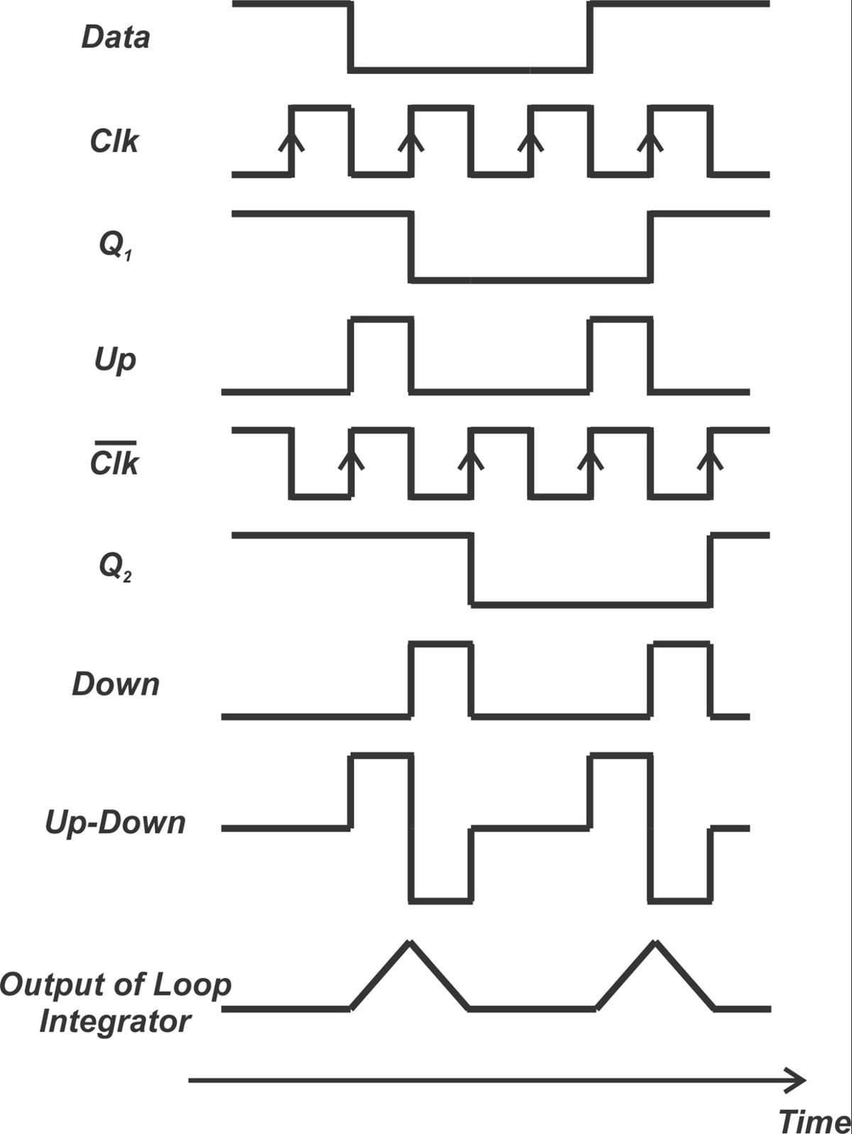

When the input data transitions coincide with the falling edges of the clock, the Up pulses will have a width equal to half the clock period. In this case, as illustrated in Figure 8, the Up-Down output has a zero average value and there is no net change in the loop integrator's output.
The Hogge detector's operation in the lock condition.
Figure 8. [click to enlarge] The Hogge detector's operation in the lock condition.
The above waveforms illustrate the circuit operation when the data and clock are optimally aligned, with the sampling edge of the clock occurring at the midpoints of the bits. While the integrator output exhibits fluctuations, its net value remains unchanged.
Note, also, that there are two fluctuations caused by the two transitions in the input data. The phase detector therefore tries to maintain its previous output during runs in the input data. This is a useful feature for CDR circuits.
