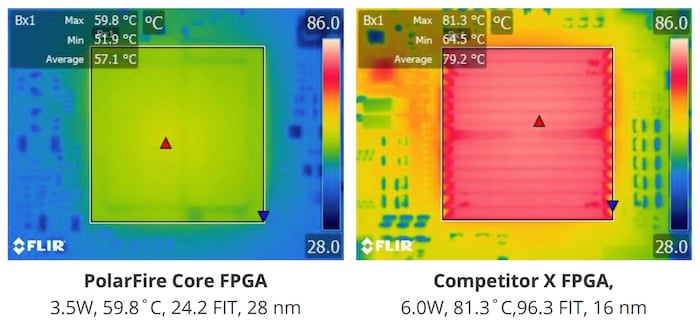

PolarFire heat dissipation
Polarfire Core can dissipate up to 50% lower total power than its competitor.
This focused feature set not only trims the BOM but also reduces total power consumption. In fact, the static power draw of these devices is roughly one-tenth that of competing mid-range FPGAs. This advantage could propel the Polarfire Core devices in markets like medical and industrial automation, where thermal management and power budgets are tightly constrained. Developers can still count on high-speed DDR4, DDR3, and LPDDR3 support, along with compact form factors, including an 11 mm × 11 mm package.
