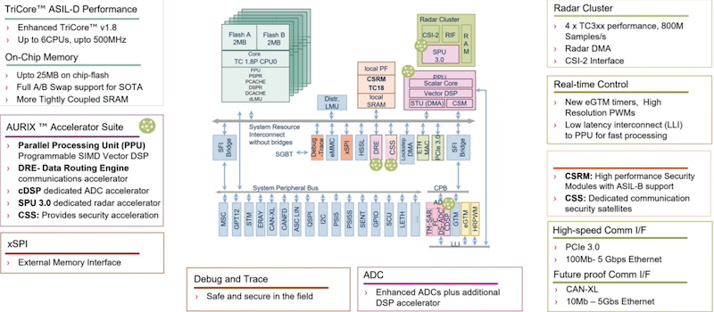

Recognizing the need for enhanced security capabilities in software-defined vehicles (SDVs), Infineon and ETAS have announced a collaboration to integrate the ETAS’ ESCRYPT CycurHSM 3.x automotive security stack into Infineon's AURIX TC4x real-time module.
The TC4x architecture
The TC4x architecture. Image used courtesy of Infineon
The TC4x is a 32-bit TriCore microcontroller that includes multiple accelerators and a parallel processing unit (PPU). It also features security accelerators and up to 25 MB of on-chip Flash with full ASIL-D compliance. The ESCRYPT CycurHSM 3.x automotive security stack also allows the AURIX to run multiple applications securely in parallel using virtualization. The TC4x is compliant with ISO/SAE 21434, an official industry standard that outlines the requirements for cybersecurity technology in road vehicles.

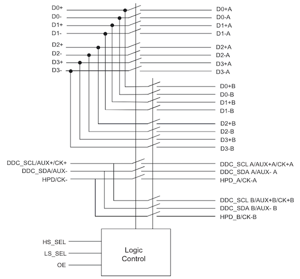

Diodes Incorporated recently announced the PI3WVR14412Q automotive-grade video switch. The multi-standard video switch supports multiple protocols such as MIPI DPHY/CPHY, HDMI, Displayport, and USB and can pass high-speed signals of up to 1.2 V peak-to-peak differential.
The switch also supports up to 20 Gbps across four lanes of high-speed data. With its ability to support a wide range of input voltages, the PI3WVR14412Q (datasheet linked) eliminates the need for AC coupling capacitors on the customer board, saving bill-of-material (BOM) expenditure. Diodes Incorporated claims this feature also improves signal integrity. The switch is AEC-Q100 Grade 2 qualified over a temperature range of -40°C to 105°C.
Block diagram of the PI3WVR14412Q
Block diagram of the PI3WVR14412Q. Image used courtesy of Diodes Incorporated
The device is available in a 40-pin, 3 mm x 6 mm QFN package. One benefit of the PI3WVR14412Q is support for muxing auxiliary sideband channels and hot-plug detect (HPD). HPD is a Displayport feature that a sink device uses to tell an upstream source device a physical connection has been established.  The AUX channel in a Displayport topology provides a lower-speed channel through which source and sink devices can communicate. For example, a source Displayport device can read the DPCD registers of a Displayport sink device using the AUX channel.
The datasheet indicates the PI3WVR14412Q provides up to 720 Mbps channel for such sideband communication.
