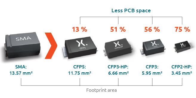

In the past three decades, SMA/SMB/SMC (SMX) packaging has been the industry standard for power rectifier diodes. However, with increasingly complex circuit designs, the space budget allocated for each PCB component has become tighter. Nexperia has developed Clip-bonded FlatPower (CFP)-packaged Schottky rectifiers as a solution to some of the size-related issues of outdated SMX packages.
Size comparison of CFP families
Size comparison of CFP variants.
Nexperia’s portfolio features four package options for space-saving designs, all with flatter profiles. They come at heights <= 1 mm—much flatter than the ~2 mm tall SMA packages. Most options also feature smaller surface areas. These size savings allow designers to fit power electronics in increasingly tight spaces.

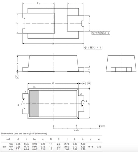

These ICs come in a CFP2-HP packaging under the name SOD323HP, with the SOD standing for "small outline diode." The SOD323HP has a 2.2 mm x 1.3 mm x 0.68 mm plastic surface-mounted body. It features clip-based leads designed for side-wettable flanks. It fits in a footprint dimension of 3.3 mm x 1.6 mm. The CFP2-HP has exposed heatsinks and enables heat dissipation (P_tot). Nexperia claims that it is comparable to that of typical SMA packages, despite its much smaller size.
SOD323HP
The SOD323HP is a plastic surface-mounted package with side-wettable flanks (1.3 mm x 2.2 mm x 0.68 mm).
